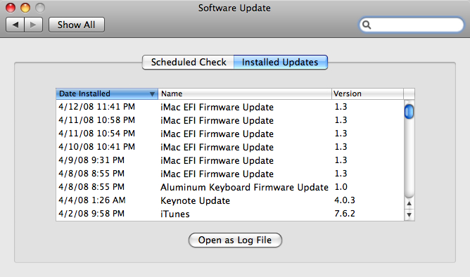

I am having a problem with the new iMac firmware update 1.3...for some reason it is giving me an option to update firmware almost every day even though i have already updated firmware....when I check my installed updates I can see it has been updated several times (see photo)....so what should i do?

It's better to download the updater separately and then follow the instructions.
The firmware update actually requires several extra steps -- shutting down the iMac, holding the power button, etc -- that for some reason you aren't alerted to when installing via Software Update.
I had this exact same issue. The v1.3 update kept popping up in SU. But when I installed it manually from the .dmg, everything worked fine.
EDIT: If you look in your Utilities folder (Applications > Utilities), you'll find the "iMac EFI Firmware Update" there. So if you like, you can also skip downloading the .dmg I linked to and just double-click on the updater that Software Update has already downloaded.

Hey thanks a lot...I have downloaded the file you linked and it did give me simple instructions to follow...
Since I am new to Mac i did not really know whats the process for uploading the firmware...its just weird that I did not got any instructions when used automatic download/upload....
one more time...thanks
The updater in software update only installs the firmware updating utility, it does not launch it (just as it does not launch iTunes after updating that, or Quicktime and so on).
You have to manually start the firmware updater and there get instructions on how to proceed. I found it equally confusing the first time, but it is quite logical after all.

When your iMac powers down, you need to press and hold the power key until you hear a very long beep.
At that point, release the power key and the iMac will boot and install the firmware (you will see a progress bar) and then reboot again.
I didn't read the instructions ( 😱 ) the first time and just powered it on normally and I received the same screen. But the instructions on that screen say "If you see this screen again, you didn't hold down the power button long enough". 😀

Although my problem has been resolved....
You are right, firmware was downloaded and executed but it came to the point where it was just sitting there and I was unable to press "Install" key...since there were no vsible instructions I was confused.....

I had the same issue. i had no idea i needed to hold down the button. in fact i set the downlads to install overnight i clicked the restrt button and went to bed. Woke up 6 hours later to a blank Desktop screen. Only when i held down the Power button out of frustration did the machine reboot and i realised that this is what i needed to do.
The instructions did appear on the software update and of course I didn't read the instructions carefully and it didn't work the first time. I did exactly what CWallace in the above post did. Maybe we should both learn to follow directions the first time, right CWallace?? 🙂 I'm a recent switcher so that probably explains it. But hey, we live and learn.
