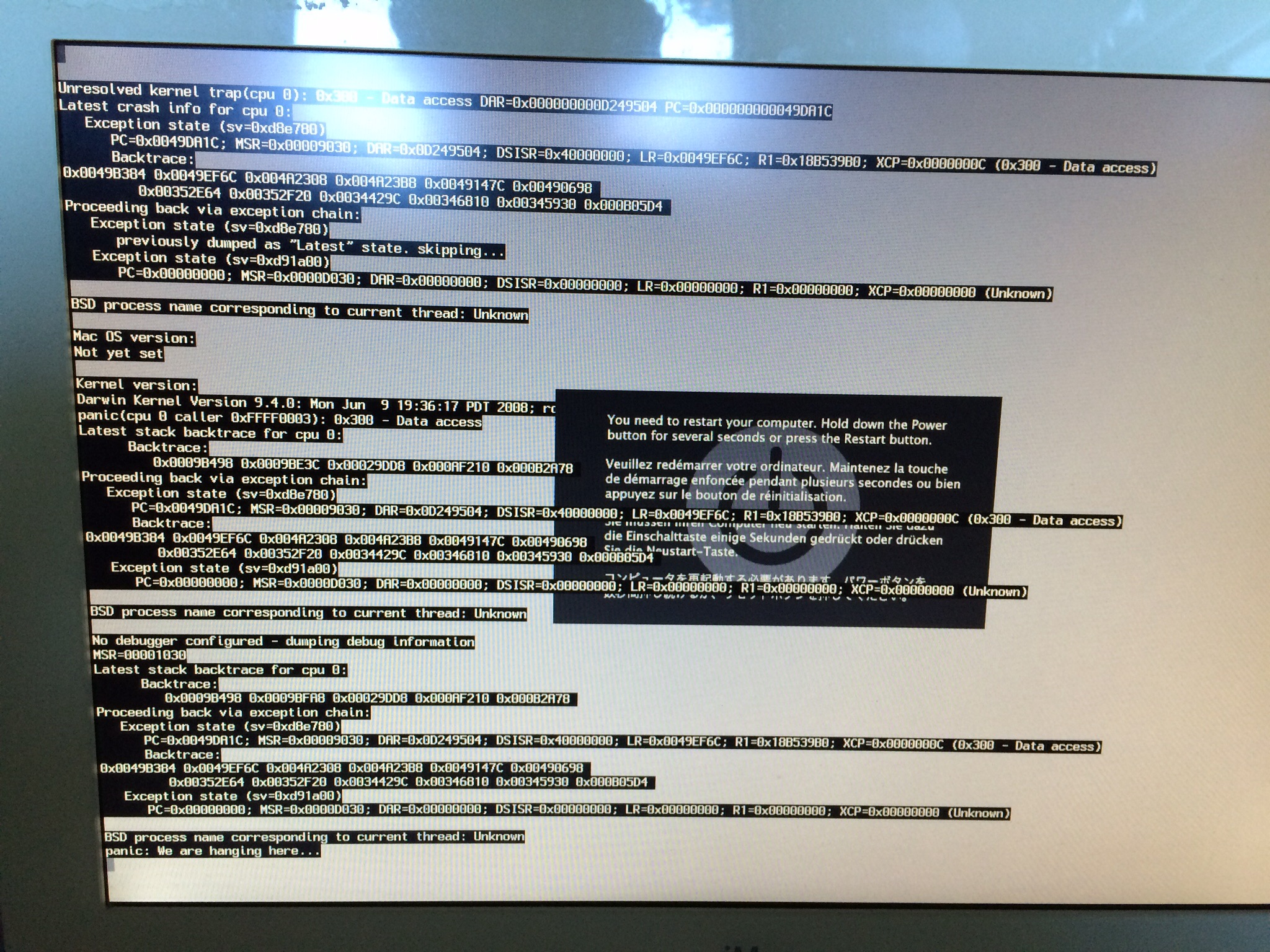

I booted without the hdd, it got to the ? Screen, flashed for a while then froze. I put the old hdd back in and got the KP below. Then it wouldn't boot for a while. Think it might be a hardware problem

What happens if you try a new hard drive? I am not convinced that it isn't a hard drive as the freezing on the ?/Finder screen is not uncommon on iMac G4s. After a set time I have seen iMac G4s freeze like you describe. Would it be possible to do a RAM test as well?

I can't really read what the screen error message says but I was having an issue with a similar screen when I replaced the RAM and HDD on my iMac G4.
I did a PRAM reset and let it sit overnight (not sure if this is needed, but I got fed up and watched a movie, then went to bed). I had the original 512 MB RAM inside and everything worked. Once I installed OS X I swapped out the internal RAM for the new 1 GB and everything's been great so far.
Before the the PRAM reset though nothing was working properly.
