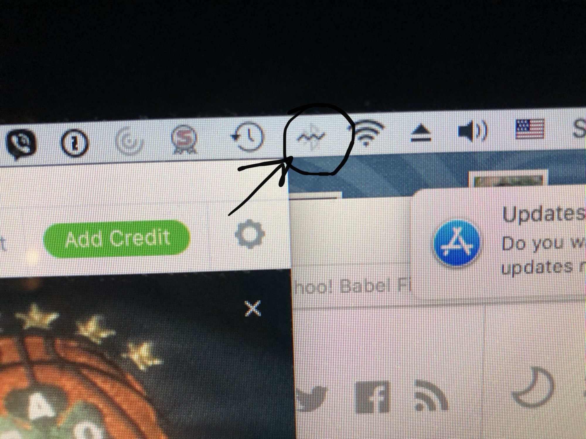

Any ideas why my iMac (mid 2011) freezes after a minute (up to 3 minutes) of operation?
From what I can understand iMac is not freezes completely as the tasks that are open, run normally!
What happens is that the Bluetooth is disconnected (the Bluetooth icon appears with a zig-zag line) and at the same time It seems that input commands are not received from iMac, neither from my wired keyboard nor from wired mouse! After that my only option is to shut it down from power button and try again.

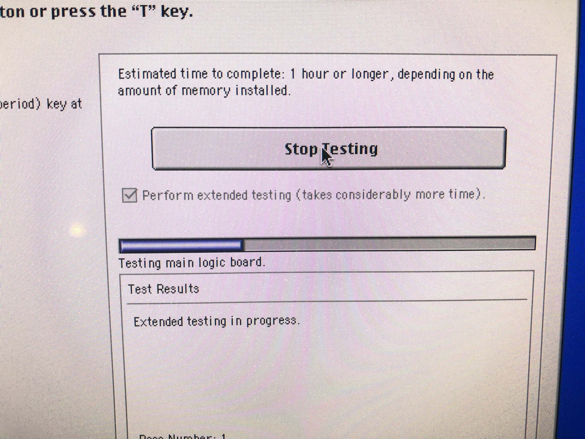

To be short...I tried it but unfortunately the pc freezed completely after almost an hour. I waited for 4 hours, just in case it was just slow but at the end I had to shut it down with power button.
Maybe will not make a difference but I'll give it a try once more. At least, I want to see if the "freezing" happens at the same point.
Just to mention that both the keyboard and the mouse did not respond after a couple of minutes of operation. I was just able to initiate the testing.
