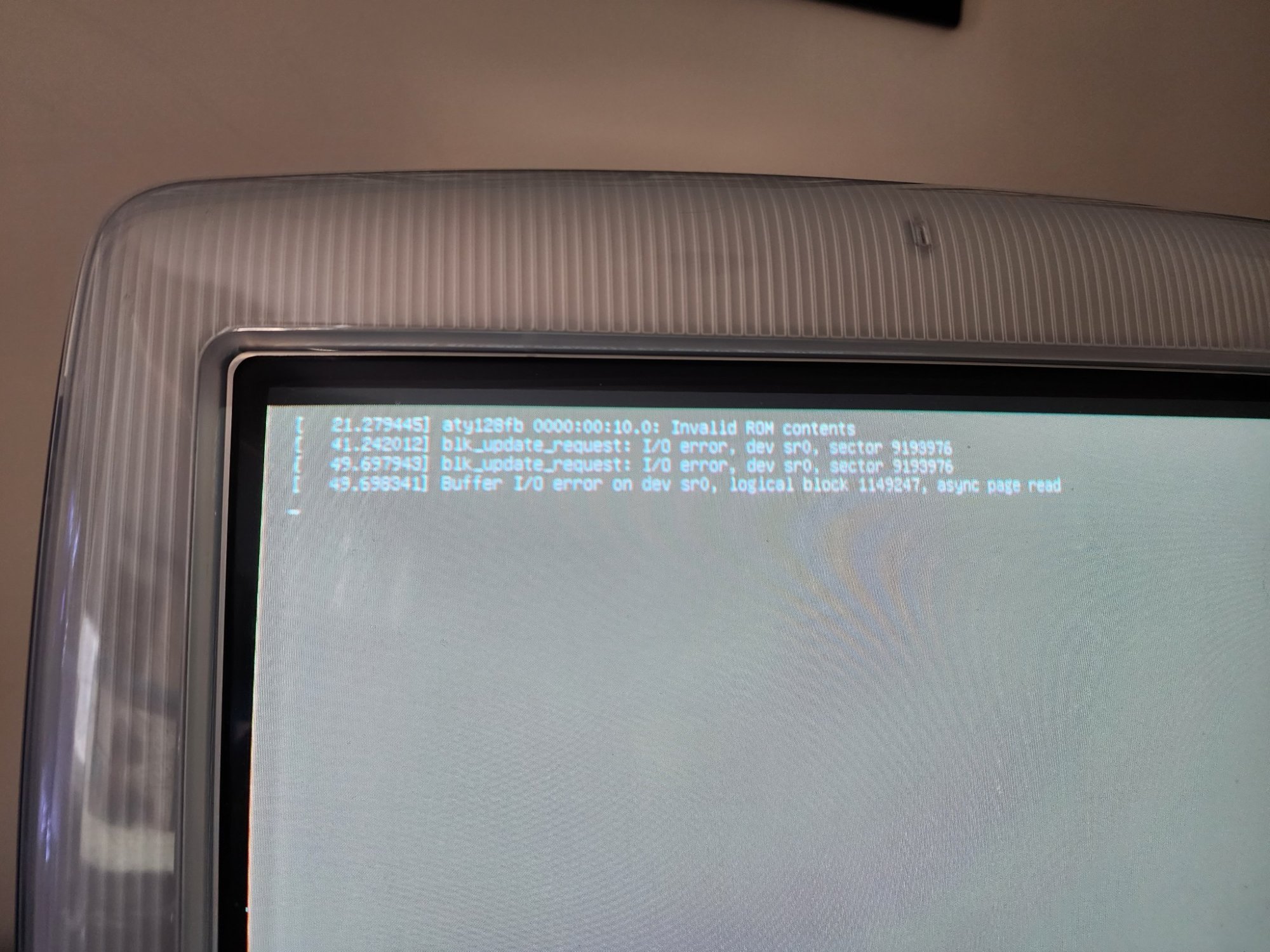

A few weeks ago, I finally found a good local (ish) deal on a G3. I'm not sure if it's an Early 2001 or Summer 2001 model, it is a 600 Mhz model with ATI Rage 128 Ultra and 512 MB of RAM, DVD-R drive and a 40GB hard drive. I replaced the HDD with an SSD, but had to resort to cloning the OSX partition to the SSD, as I can't seem to get anything to boot from removable media.
I've tried various images I've found of OSX 10.4, and Lubuntu 16.04 PPC, on DVD and USB. Lubuntu from DVD is the only thing I have managed to get farther than a 🚫 screen. As it boots, I get the following error messages:

It will repeat the I/O error line a few times, then it stops. Is this indicative of an error with the DVD drive? I've tried booting the same image from a USB thumb drive, and from a USB DVD drive, but it doesn't even get this far.
From what I've read in this Ubuntu Forums thread that error looks like the sign of an incorrectly burned DVD.
