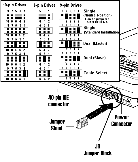

What are jumper settings and how do I change them?
Okay, I found out what the jumper settings are. They are on the side of the HDD, right? What should I set them to?
There should be a diagram on the hard drive itself. Either that, or small characters printed near the jumpers themselves. Look for "Master" or "Single" on the diagram, or "MA" printed next to the jumper. You'll need to put a jumper block on (the small plastic piece that shorts the two prongs) to enable the master setting.
Also look on Western Digital's support pages for an image. I found a good lot of useful stuff right here, plus the image below might help.

Oh, so I should set it to master? Then it will work?
Sorry to sound so dumb, guys. 🙁
Yeah if you set it up with the "(dual) master" configuration it should work.
