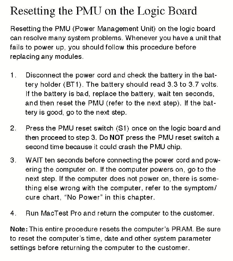

It's very easy to replace the pram battery. There is something about having to press the reset button afterwards or the battery will drain out in a couple days. Somewhere on the internet is a file called "slot-load_imac.pdf" that is very helpful for working on old slot loaders. Attached is the bit on resetting the pram.
Edit> Aha, here it is:
http://mrjcd.com/slot-load_iMac_repair/slot-load_imac.pdf
