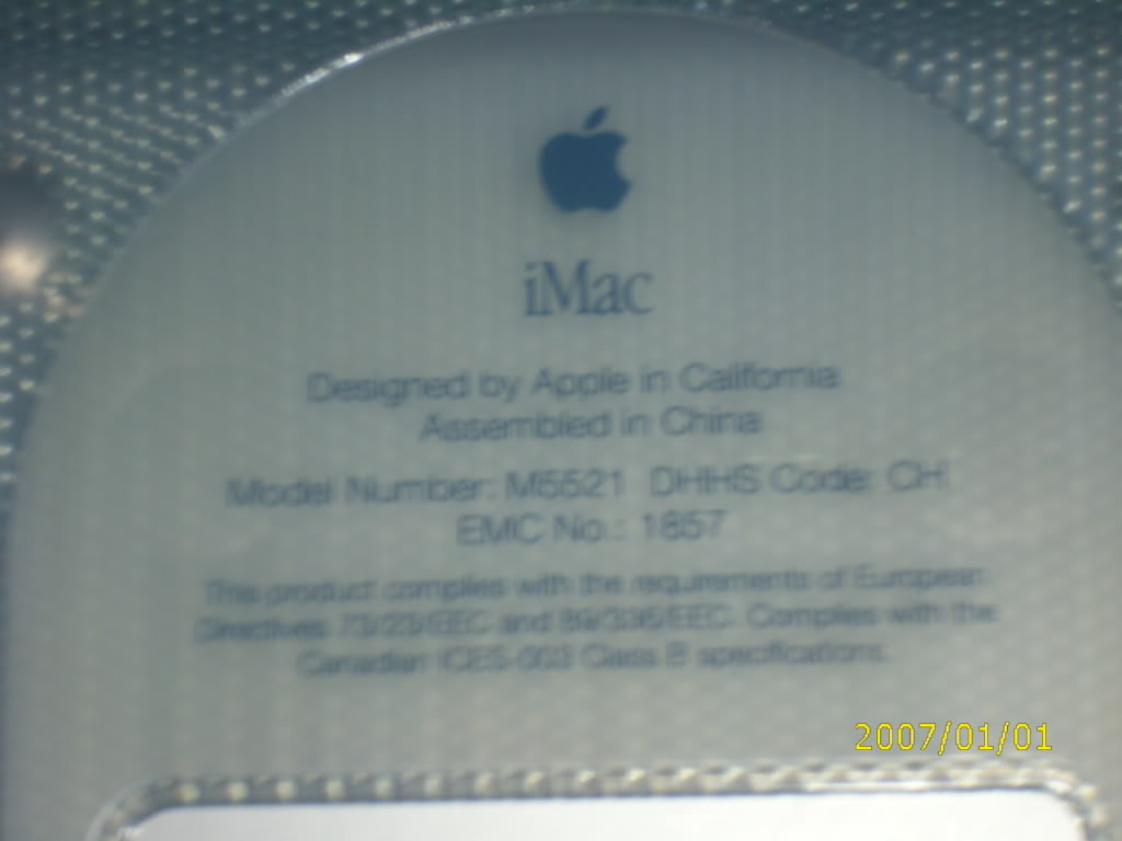

Its a slot loading "blueberry" with two firewire ports I can get a picture of the lable on the bottom if it would help. it has 64MB of ram and a PowerPC 750 (G3) 400 MHz
Here is the pic I was talking about.
Sorry in advance for the poor image quality I was rushing to take the picture.
HD With question mark usually means that the HD is bad, or has bad sectors. I would triple check the drive in question, try & swap the drive with a known good drive.
there is no HD with a question mark its the finder face/question mark it switches between them and its on a folder I am sure most of you know what I am talking about. I am fairly sure that the hard drive is not bad it formatted fine with out a problem I just formatted it to NTFS not so much to change the format I just formatted to make sure it was 100% clean and clear and the winxp machine I had it plugged into did the normal diskchk after the winxp load screen and from what I know what bad sectors it may have found if any where repaired.
The picture helps, and we understand what hardware you have, now, but I'm still fairly lost. This iMac can run OS 9 or it can run 10.x, although you would want more RAM for that.
