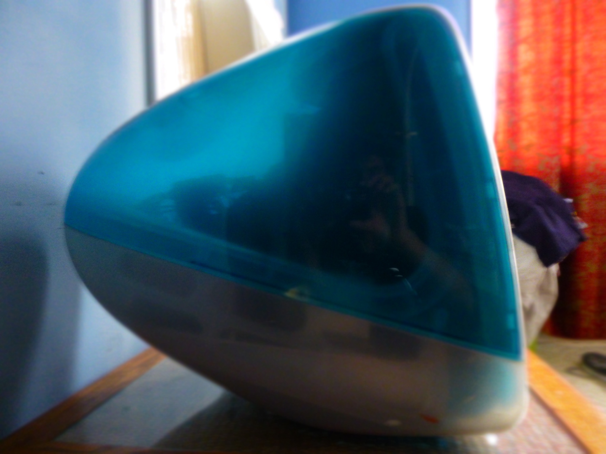

Bonjour! I have a slot loading (Bondi Blue; 333 mhz, I think) iMac G3, as of right now, I have nothing to do with it. Of course, I could put system 9 or tiger on it, it's fairly easy. But I feel like making it a fully fledged modern all-in-one. Aside from wanting it to be able to run OS X Mountain Lion, Does anyone know what type of motherboard I should use? Also, tips are very much so welcome! This is my first hackintosh, I'm very excited and I really want to capture the essence of the first gen iMac. :apple:

If its slot loading it will be a Blueberry iMac not the Bondi Blue exclusive to the original iMac. You will most likely have the iMac DV model number M5521. Your biggest issue is going to be the custom size/shape of the motherboard.
I'd imagine your standard sized motherboards for most hardware out there is not going to fit, you may even have to go down to something like Nano ITX and then you'd have a whole lot of other issues, i.e. not running a full scale CPU, having enough power to run it and etc.
If you wanted to reuse components such as the monitor etc, you could do it as the monitor uses a fairly standard d-sub connector, however you're going to have to work out the pinouts to connect it to something modern. The standard CRT monitor is going to take up a fair bit of case room though.
If you do decide to pull the monitor out you face the issue of discharging the transformer/capictors, which is not for the faint hearted if you've never played around with CRTs before. Do be aware there is enough voltage in a CRT monitor to kill you 10 times over if not properly discharged.
I guess you could save a lot of room by going down this path and replacing the monitor with an equivalent sized LCD... probably 13" or so as it translates for monitor sizes between CRT and LCD.
Once you've got an empty case you're going to have a whole lot of fabrication to do, mounting posts for a motherboard, probably Micro-ATX, finding a place to mount a power supply and making mounts for it, remounting an optical drive and hard drive and then working out things like a CPU that will run cool enough not to cook itself in the iMac case.
No matter which way you look at it it's going to be lots of custom fabrication to get things to work. Not for the faint hearted if you don't know a thing or two about computers and best left to the experienced modder.
