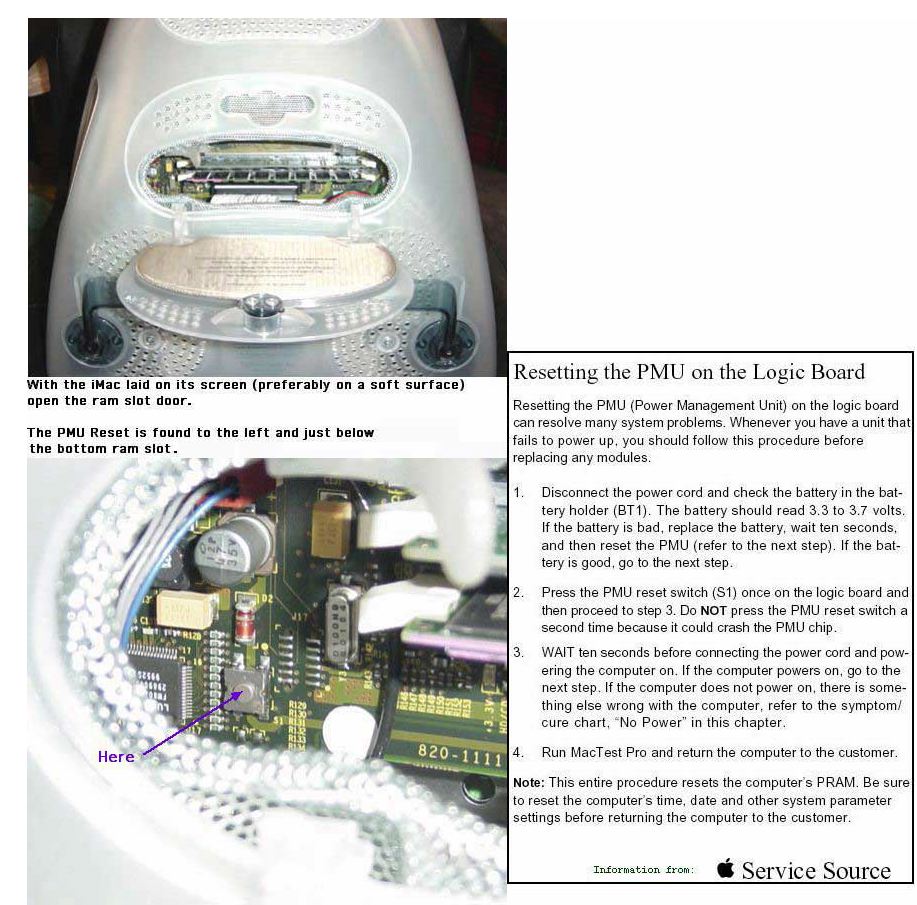

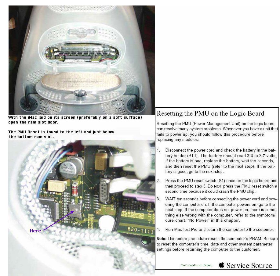

There is also a PMU button on the motherboard you can try but be very careful as static electricity can cause damage.
Turn off the mac, disconnect all cables and turn it around. Under the ram module cover you can find a button on the motherboard which resets the PowerManagmentSystem.
I always use a wood stick like a chop stick or similar to press the button to avoid any contact.
Good luck.
