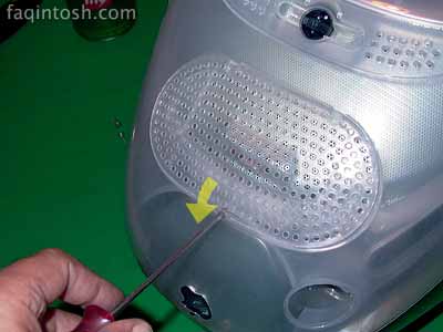

The VGA port is in a tricky location on iMac G3s. It is not located with the other ports on the side, rather, it is on the underside/back of the machine. I attached a picture that may help with this.
