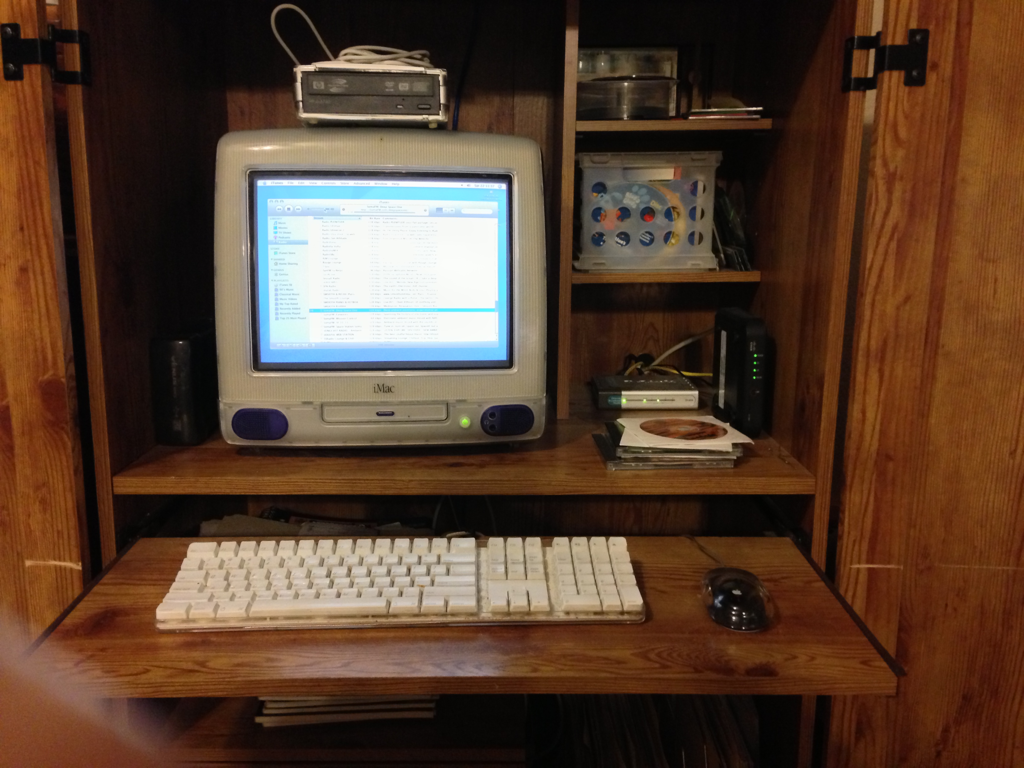

Well, it works to do this.
iMac G3/233mhz (no Firewire), 96mb ram, 40GB HD running Tiger 10.4.11.
iTunes 9.1.1 streaming SomaFM Deep Space One (128kbps).
Not bad I think for 96mb ram.

But .... 1) How did you break the 256mb minimum to install Tiger - or was it that you just put in a pre-installed hard drive with Tiger on?
2) I have the exact same enclosure (firewire + USB) as the one above your iMac, currently holding a 320GB backup drive
Cheers 🙂
Hugh
Sorry, just realised, no firewire, so you had to have had a hard drive already installed with Tiger
Cheers 🙂
Hugh

Yeah, the original drive is 6GB. I had a 40GB drive from my PC laying around, so I made two partitions, one 6GB with OS9 Drivers and the other 34GB. I used a USB enclosure to install Tiger from my Quicksilver, then put the drive back in the iMac.
Took me two tries to get it right because I didn't realize that I had to partition this way and that the OS9 drivers needed to be installed. I also had the drive set to "slave" on the jumper the first time around.

I've pulled the thing apart twice now and the first time was surprised to learn that uses laptop memory (first time I have EVER owned an iMac). Unfortunately, my old 512mb chips from my 17" PowerBook don't fit.
Yup newer PB's use DDR RAM. I'll have to see if I can dig some up. How much you have in it right now?
EDIT: Oh I see 96MB... I might have two 128MB or maybe even two 256MB sticks... if not I know I have two 64MB's. Do you know which revision iMac (A= Rage IIc, B= Rage Pro) you have?
96mb total.
32MB chip on the bottom and 64mb chip on the top.
512mb is the max it can take, Mactracker tells me 2x256mb chips.
