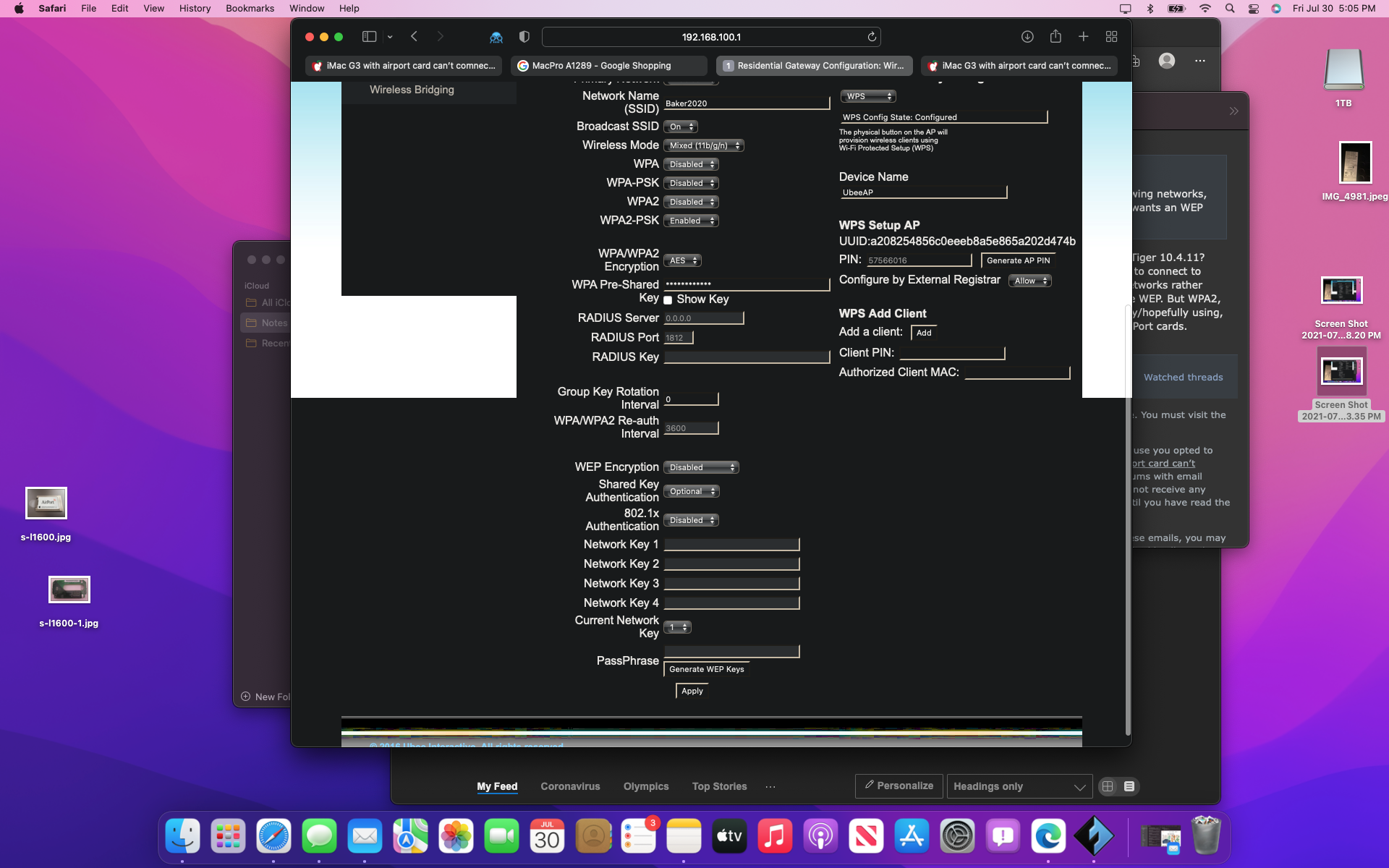

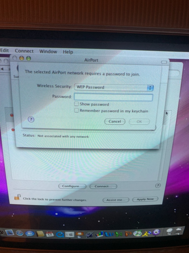

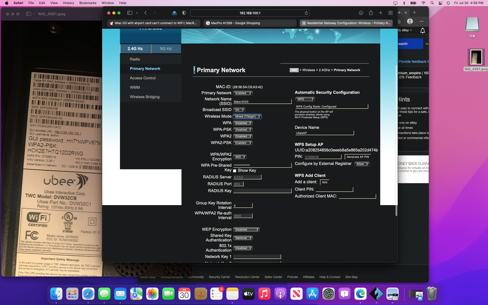

Hi, the card and adapter are working fine. I did forget to plug in the antenna properly, but figured that out shortly after I posted. I am running 10.4 tiger by the way, and have both 2.4Ghz and 5Ghz. The airport card is now showing networks, including mine, however, it wants a WEP password. I have tried typing in my wifi password many times but it comes back with an error connecting. I have a router and modern in one. I am not sure how to change the settings to allow 802.11a/b. I am able to login into the UI for the router/modem on my MBA M1. Is there something I should be looking for specifically? Also, if I am able to change the settings to allow for 802.11a/b will it cause my other devices to be kicked off the network? Final question, would purchasing an AirPort Extreme base from 2003 allow the airport card to connect to wifi (thinking worse case scenario here, lol)? Thank you for your response, please get back to me when you are able.
EDIT: see last photo it appears it is already set to b/g/n. Is there another setting I should try enabling?

The airport card is now showing networks, including mine, however, it wants an WEP password.
Are you fully updated, i.e. on Tiger 10.4.11? That should at least allow you to connect to WPA (i.e. WPA1)-encrypted networks rather than just the woefully insecure WEP. But WPA2, which your network is probably/hopefully using, is a no-go with the original AirPort cards.

It is updated to tiger 10.4.11, maybe I did the install for those updates incorrectly? I edited the post you responded on with a new photo, maybe the last photo will help determine if I need to change a setting? I see on UI settings for the network that WEP is disabled, unfortunately it will not allow me to enable it.

It is updated to tiger 10.4.11, maybe I did the install for those updates incorrectly? I edited the post you responded on with a new photo, maybe the last photo will help determine if I need to change a setting? I see on UI settings for the network that WEP is disabled, unfortunately it will not allow me to enable it. View attachment 1812945

Your router is running WPA2-PSK with AES encryption. If you want to connect, you'll need to click the popup for that and choose disabled. Then you'd click the popup for WPA and select Enabled. After that you'd change the encryption to TKIP.
Then you could connect. To do all this it'd probably be better to connect to your router via Ethernet.

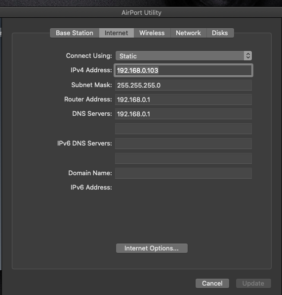

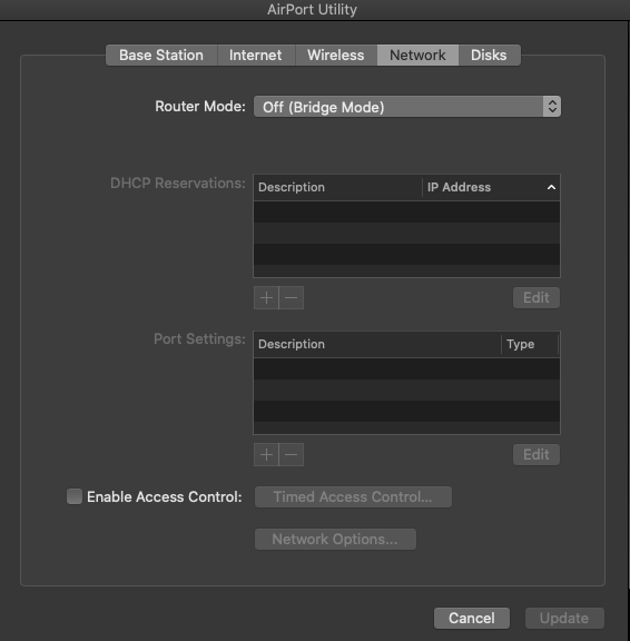

If you really want to run the Airport Extreme base station, then as mentioned connect it to your router via ethernet cable. With the Airport Utility I'd further suggest setting a Static IP on the Internet tab and then putting the base station into Bridge Mode.
Note, the Router Address and DNS Server Address are going to be the IP address of your primary router.
View attachment 1812959View attachment 1812958
Thank you for all of your help, it's made a huge difference!! I decided I am going to buy an old AirPort Extreme base station. Thank you, thank you!
