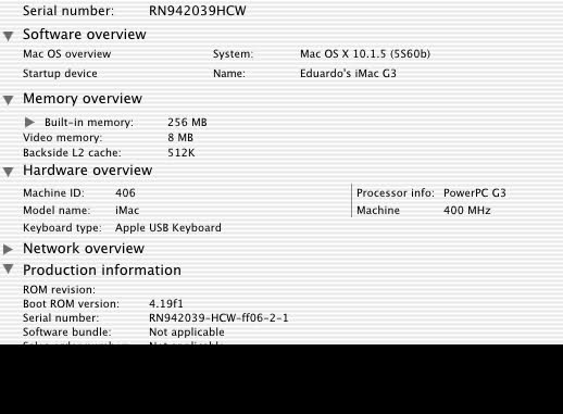

I have a feeling that Apple -> About This Mac -> More Info... should work.
Mind you I only have about 2 hours of 10.1.5 experience.

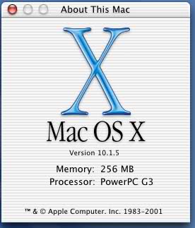

This is all I get.
I agree, you have bad RAM.
Pull the 128 stick out and try to load Tiger with the single 256, because you mentioned you have 384MB.
I've put 10.4 of 5 of my iMac G3's 400-600MHz with no problem. To run Tiger, use minimum 512, 768 is better, and 1GB RAM is best!
But wait!! You're "About This Mac" window says 256?

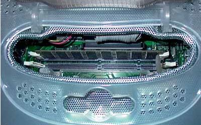

Open the RAM door underneath and see if there are two sticks or one!
Here's a picture of a single RAM stick inside.
I have 2 128 MB sticks in it.
