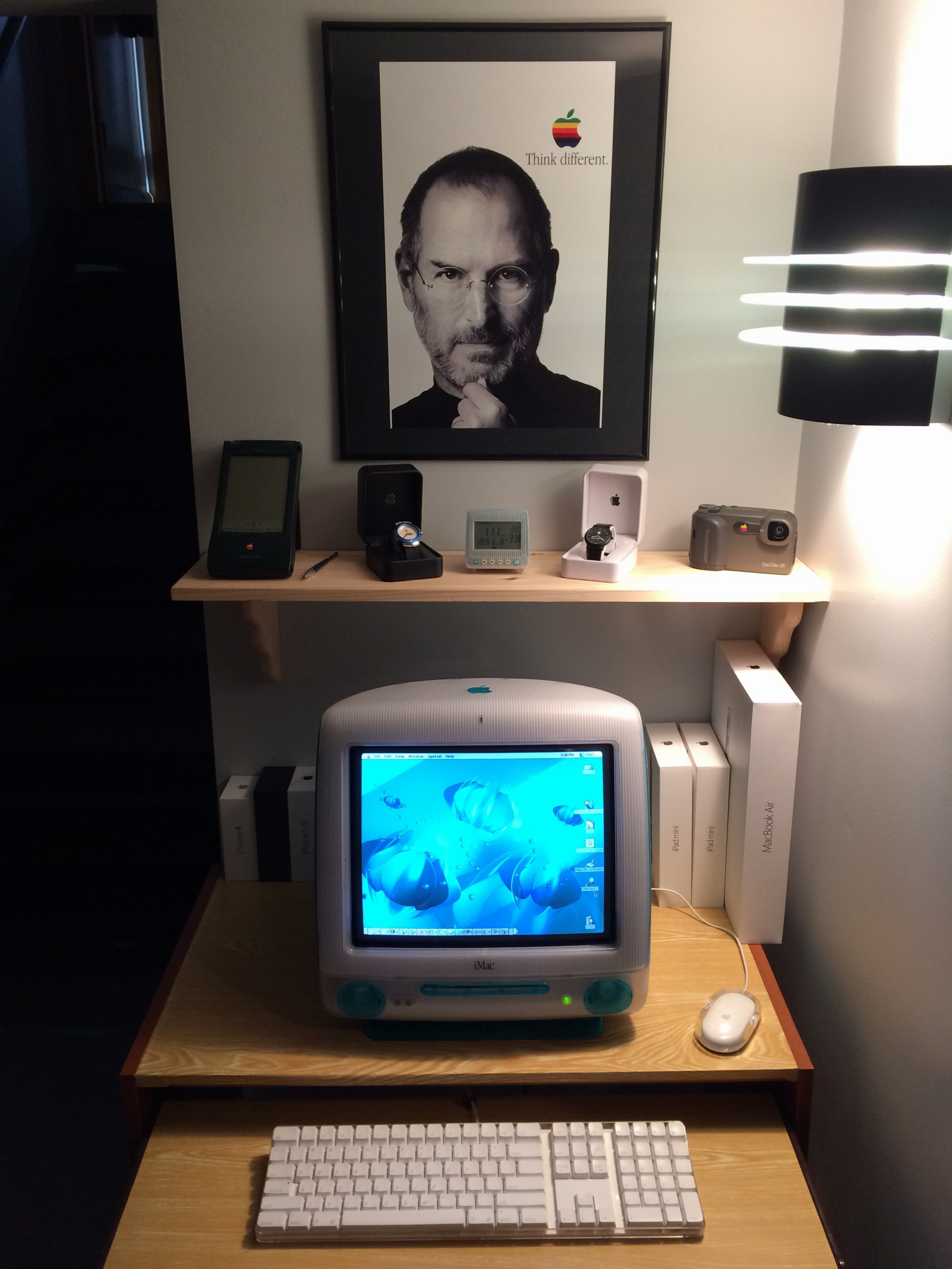

I really just bought it to ad to my small collection of 90's Apple stuff (pictured below).
What I'd like is that this machine just works. So a couple of new questions. I have a airport wireless card coming, hopefully that will work to get me online. Once I do get online will I be ok using the OS 9.2 and the internet explorer 5 and Sherlock?
Don't ask me what my purpose is. I have newer equiptment that does everything I need. I guess I just wanted to see if I could get it online.View attachment 562886

iMac G3s(slotload) require a special riser card for the airport card.(trayloads can't take an Airport card). The Airport card sits next to the RAM.
The whole assembly looks like this
