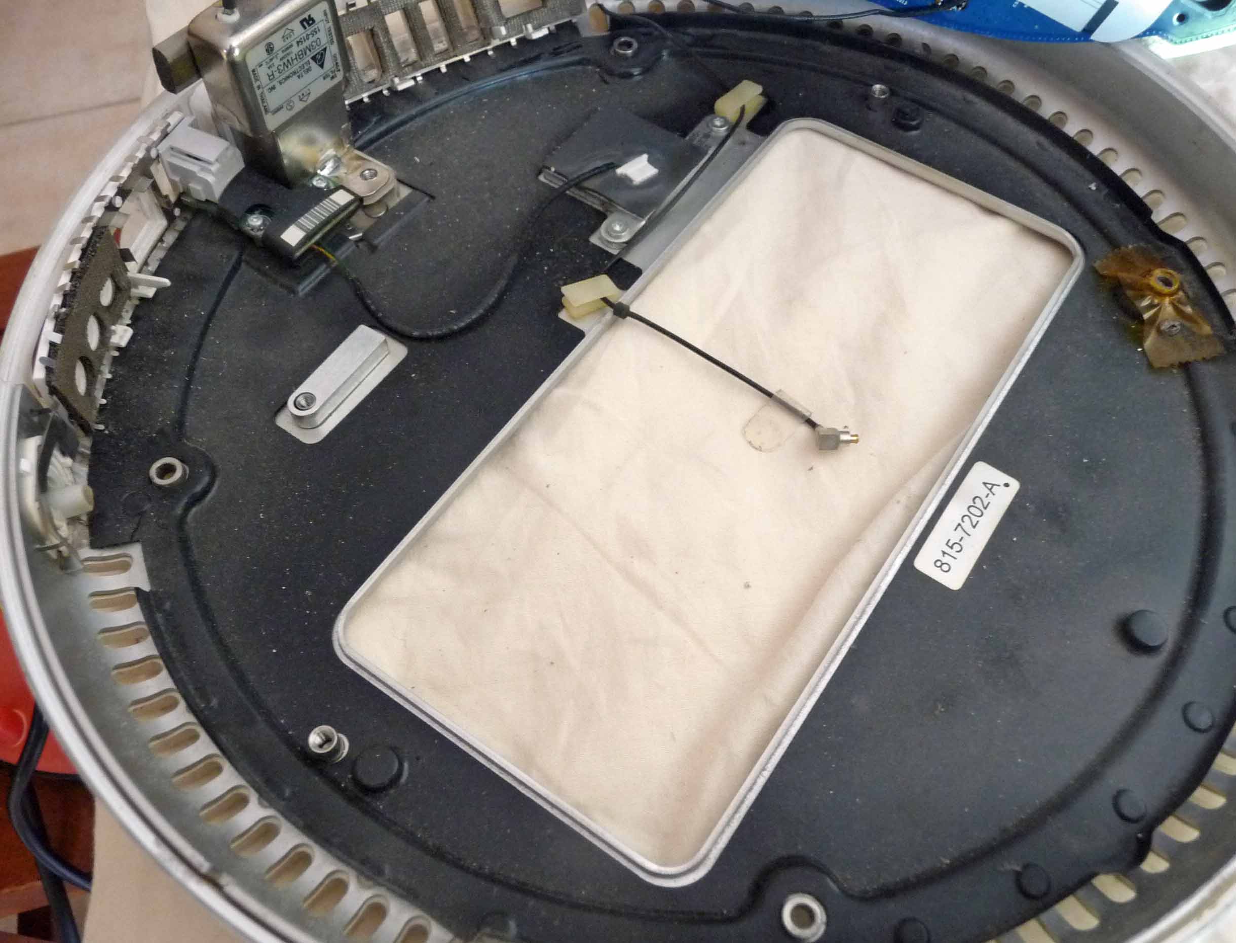

Regarding thermal pad beneath the logic board, there is one. Replacement takes only minutes once the logic board has been removed. See following photos:
General view with logic board removed. Thermal pad is black (with white bluetooth connector lying on top).

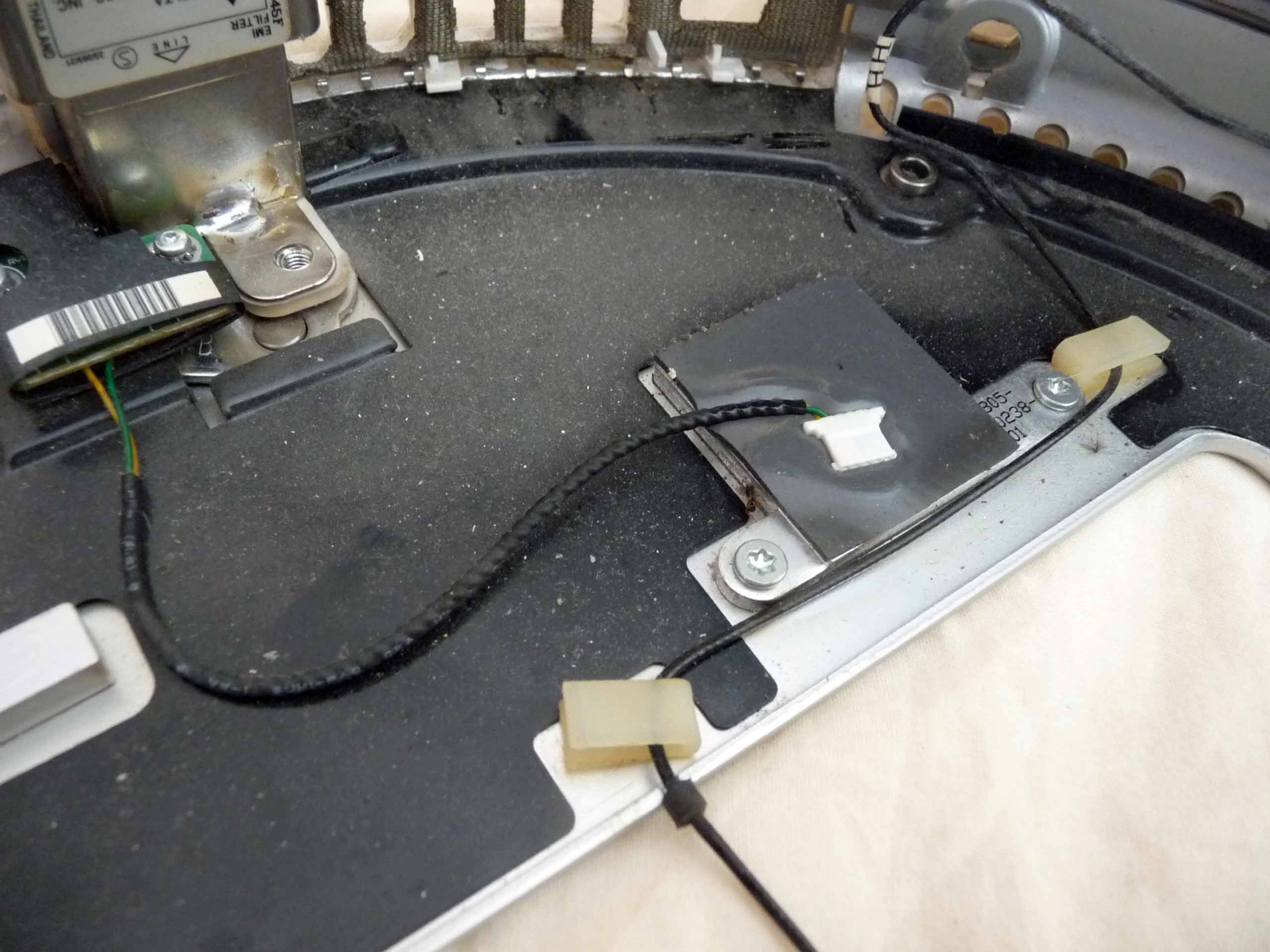

Below: Detail of thermal pad. Unused blutooth connector had been misrouted during a previous assembly and compressed into the pad. 😱

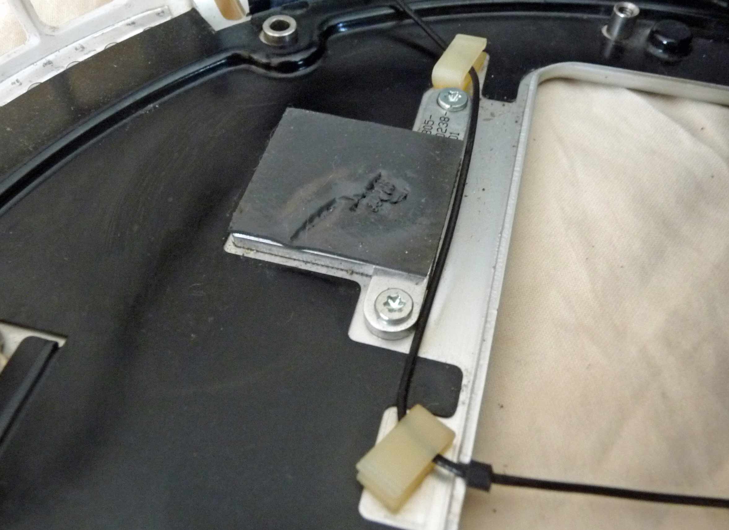

Below: Thermal pad just prior to removal. This was replaced by similar 1mm pad material (blue) purchased via Amazon.
The original pad was measured and found to be approx 0.8mm, so allowing for compression during previous use, I figured 1.0mm thickness was a suitable pad thickness for new replacement. As I was so keen to re-assemble the iMac I didn't think to take a photo of the new pad following the change.
Everything worked fine as a result, (as it did before I started), as this was just a general refurb and internal cleaning - which these G4 iMacs need from time to time if in use fairly regularly.
