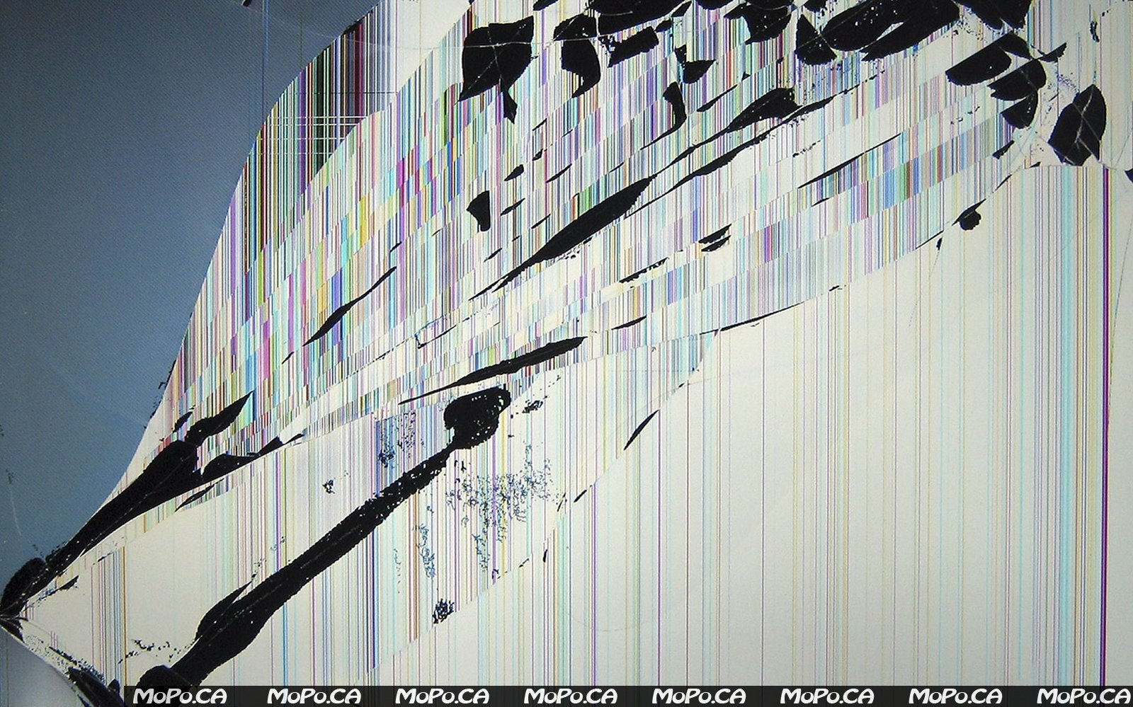

I just received my iMac G4 with 15" LCD screen through eBay.
When I switched it on, the screen only showed a picture of broken glass.
Yet when switched off, I cannot see any signs of cracks anywhere.
Can someone tell me what this means?

That the actual LCD is broken.

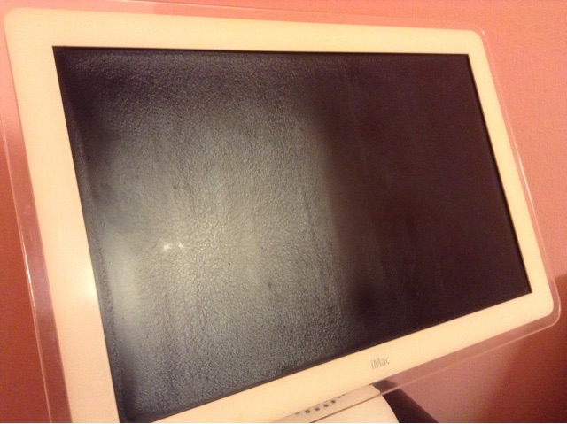

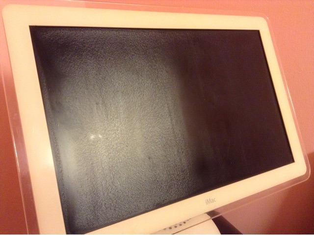

Hi, were you able to replace the screen..... I have an issue with my screen, not broken, but I think it is the glass panel ....not the LCD.
Any feed back from your experience would be much helpful....
This my screen...it's only visible
