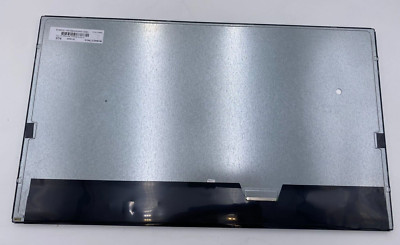

I have a 20” iMac G4 that has some display discoloration around the border and would like to replace the LCD panel. In addition to the G5 panel, does anyone know if there are other/more modern panels that are compatible as well? A 1920x1200 panel would be a nice little upgrade in resolution but not sure if any of those are drop-in compatible…could something like this work?…
