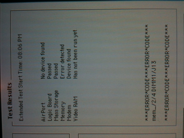

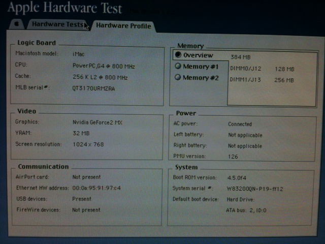

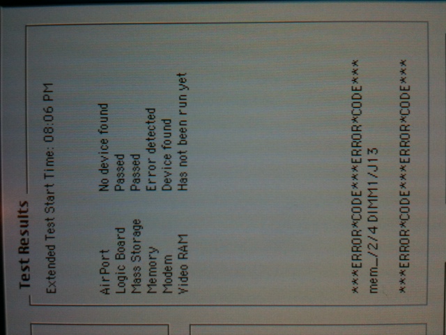

OP: try making a AHT CD with the stuff above, and rebooting using it, as it tends to be the best way to diagnose problems with various internal pieces of your G4. Leopard isnt the problem or solution currently 🙂
No worries!! Ok, about to make an AHD CD .... hold your breath .... not literally!!
Back later ....

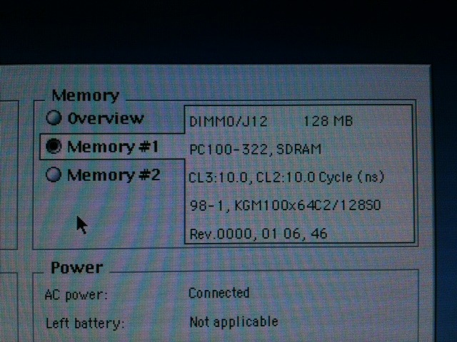

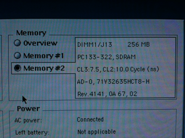

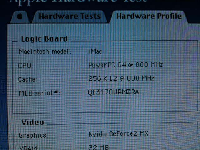

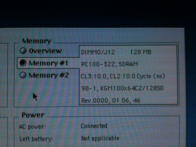

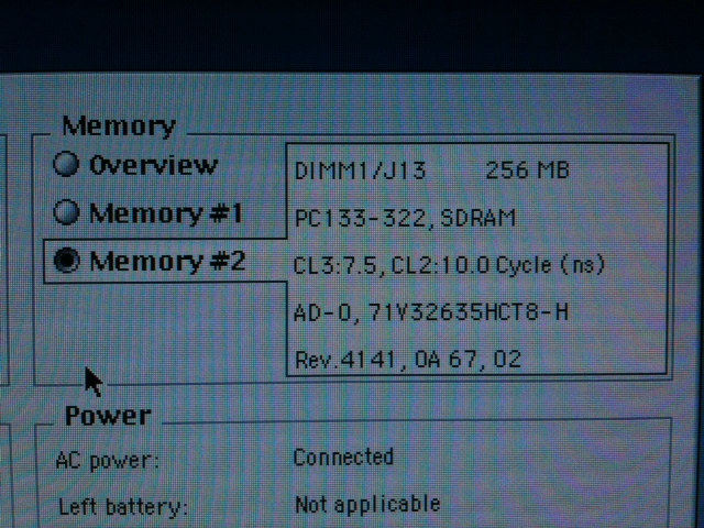

Ok .... it's memory. If I'm reading it right, it's the 256mb extra Kingston stick that is faulty, yet when I remove this it wont boot at all ....

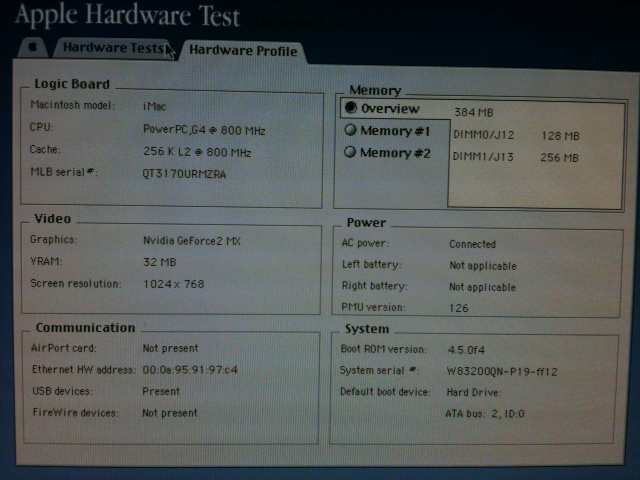

What I don't get is why it wouldn't boot without the dodgy stick in. Just a black screen with the power indicator in the bottom left of the LCD panel on.
:gulp:

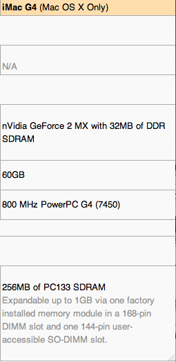

That's probably because your 800Mhz model has a min. RAM requirement of 256MB. Logically, 128MB won't work.
As stated in this screenshot. MIN 256MB.

Ah ok, that has given me an optimistic view!!
So, there must have always been extra memory in the expansion slot in order for it to work, even when it left the factory??
Yep, This has been Apple Practise generally when they had logic board RAM - even my 1996/7 PB1400 shipped with 8MB in the expansion and 8MB on the logic. Im pretty sure the iMac G4 shipped with 128MB in the expansion (IIRC that is)
OK, that's cool. I was just going on the fact that on my iMac 17" 1.25ghz the memory slot underneath was empty so I assumed they all shipped like that. Good to know!!
Now, that leads me to my next thought .... the memory in there now is Kingston - Apple don't use Kingston do they?? So if not, it's got through at least 2 sticks of memory in it's lifetime (whatever it shipped with plus the Kingston stick).
