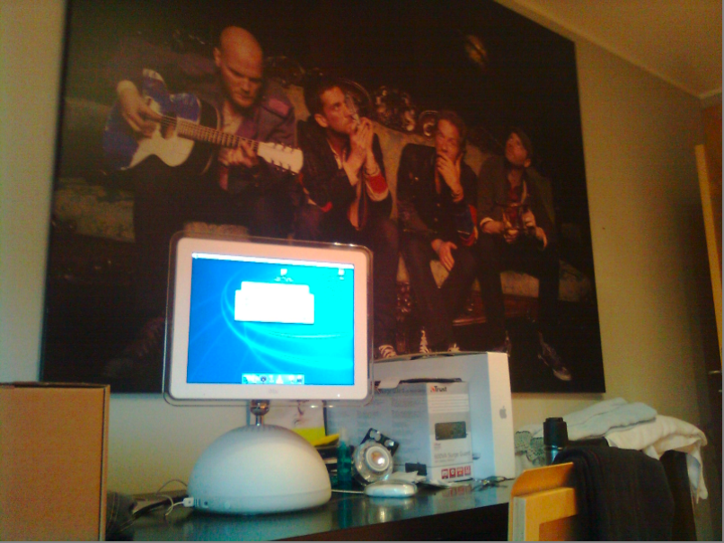

It is working .............for now....
IT turned on!!!!!!!!!!!! i tried the shift key when i was pushing the power button and it turned on in safe mode
Now i am afraid of turning it off..... should i do something?
Usually when it boots like this as soon as i restart it gets moody and stop working, should i fresh install tiger now?

Good new- problem solved
IT works!!!!!!!
After trying to boot like 40 times i managed to do it and inserted the install disk, ereased it - partition - fresh install.....
After the new fresh install everything is working, tested it with several restarts and shut downs. everything working fine, after a week of cleaning and troubleshooting my "new" imac g4 i am finally happy with this classic
Freaking sweet bro. Congrats on the solve job.
Btw, looks like Midnight Oil in the background, but I know it ain't...🙂
