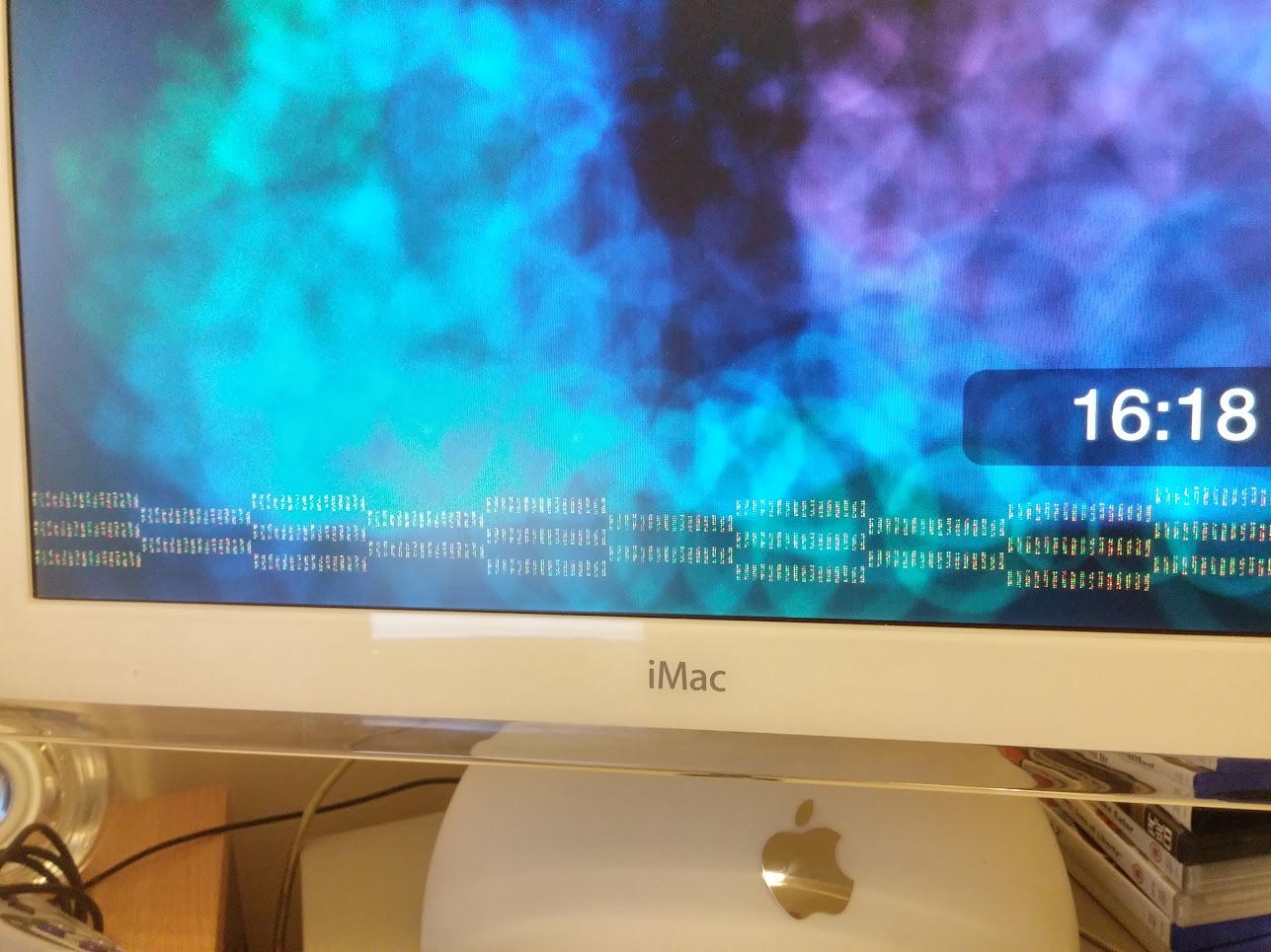

My imac G4 suddenly decided to have colour issues when I booted it up the other day after not being turned on & unplugged for a week. I've attached a screenshot. Interestingly if I go preferences > displays and change the number of colours to thousands and then back to millions it seems to sort itself out. At least for a while if the screen saver comes on it can sometimes go funny again.
I'm guessing its almost certainly hardware and I know the imac g4 is a nightmare to take apart so I might have to hunt down a replacement but if anybody has any ideas that would be great. I've tried resetting the PRAM and multiple restarts but no luck 🙁

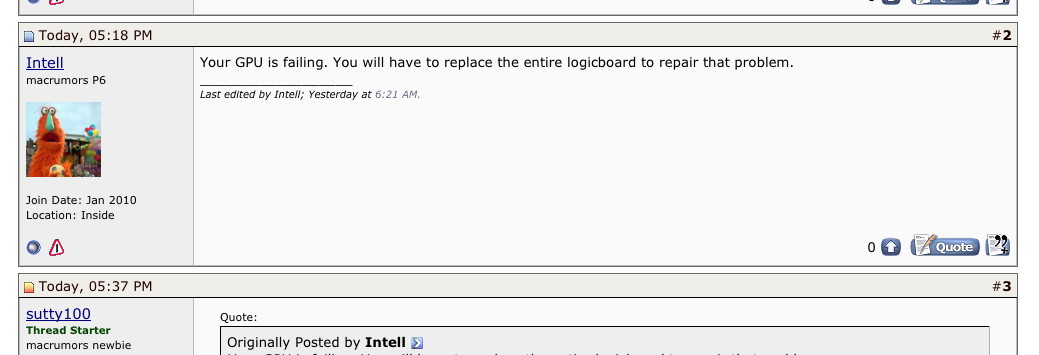

Something odd about Intell's post.
