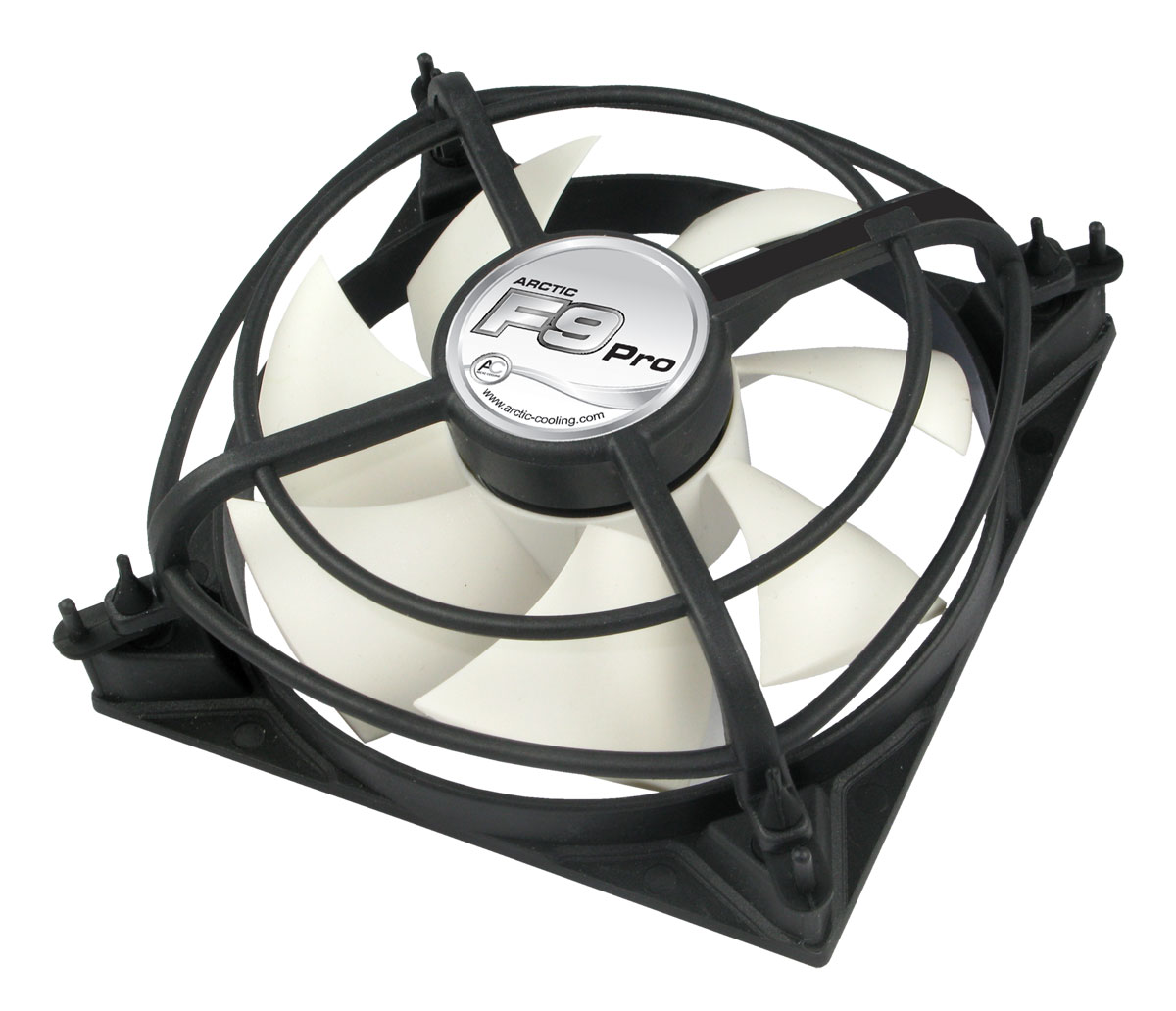

Okay, what you need is an Arcic F9 Pro, not very much on ebay and have open sides. the iMac G4 is a 92mm 12V fan.
This is what i would fit;
