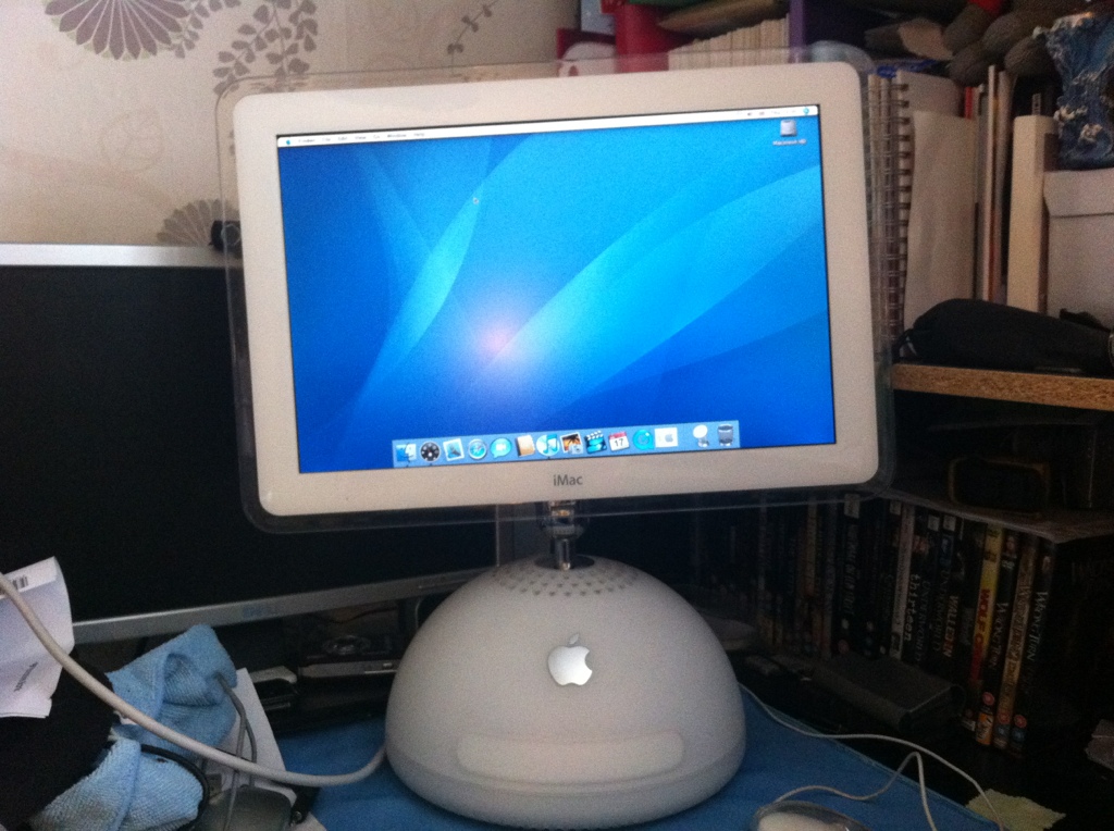

So my g4 just arrived and its in perfect condition, except the screen is slightly tilted to the left and I'm worried that the arm is damaged. It feels abit loose around the base but I think the whole thing may be bent and want to know if anyone has advice, not sure if you can tell in the pic but it does lean to the left if I hold it with my hand it does go straight but won't hold, help please!

Turns out I have to remove the display loosen the back screws, adjust then tighten

Well these screens are known to tilt slightly to one side apparently, so i took a hex key and went to undo the screws under the screen. The Hex key actually snapped in the screw head and is pretty much flush now, so now i can't even take the screen off. I need some ideas on how to get it out without damaging anything. Using a temporary fix by shoving a bit of foam under one side of the base but i really want it done properly. Also there was a lot of dust in the base 😛

Magnets? You could use a coctail stick and some superglue to get the hex key out.
Could you just drill it out and replace the screw?
I don't want to do that the screws so small I'd risk damaging something else, my last resort would be to get the smallest dremel I can find, and carefully cut a slit into the actual screw head so I could then take a flat head screwdriver and unscrew the screw, the worst that can happen then is a little damage to the case which wont be seen. Obviously this Is the last thing I want to do and I will keep trying everything I can before I do that.
Yeah looks just like the pic. But only when the arm is down I think the arm is twisting as it comes down.
hmm if the arm twists as it comes down it may start to seperate as mine did when i tried forcing to screen to straighten up, if your screen is perfectly straight when its raised then it may be the arm I'm not sure, if so you will need a replacement. You could always try to straighten the screen like i did if you don't mind taking things apart. I advise you to read the screen disassembly instructions in the service manual found on www.macmanuals.co.uk (the screen disassembly part is on page 84). After you remove the screen itself if you follow the instructions you will eventually get to just the back housing of the screen which will have 4 Torx 10 screws connecting it to the arm, loosen them enough so the housing moves and straighten it, maybe use a spirit level to get it exactly right. Then tighten it back up, don't do it too tight i think you need to leave a bit of give in the screen but do it so it stays in place. After that follow the service manual again to reconnect all the wires and put your screen back together. Ive tried to explain as clearly as possible but if further assistance is needed i can add to it. I advice to have the correct tools for this because its always easier to do so. Anyway hopes this helps you, if not hopefully it will others and if your arm is indeed bent i would recommend buying a new arm from eBay. The arm replacement is more complex but is also explained in the service manual.
Well the chrome pieces were not fit together right so I grabbed the arm and started twisting it and the pieces started to pop back into place now its ok.
