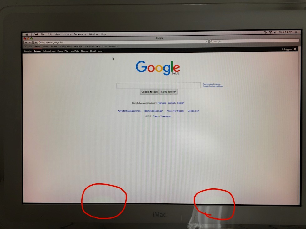

After one year of non-use I started up my iMac G4 20" 1.25Ghz last week, when I noticed two discoloured spots at the bottom of the LCD screen. They are in the shape of a wave, each about 3cm wide and 2cm high. Both are located 10cm from the edge of the screen (symmetrical). (see attached image)
You can only see these spots with a light background. The mac has always been stored in a dry room. So I am not sure what may be the cause of this defect.
Is there an easy fix for this problem? Or do I need to replace the panel?

Yes, I'v'e seen this on at least one of my screens, but can't recall which.
Have just fired up my iMac G4 20" to check. Couldn't see anything untoward, but as my desktop is a dark blue which may mask an anomaly, I then opened a textedit white page to double check. Still don't observe the similar problem that you describe.
It may even be on one of my Apple Studio displays that I've observed this, I'm not sure. But either way it's never troubled or distracted me in general use.
I wouldn't have a clue if there is a fix for this. Others more informed than myself may be able to advise.
It is polarizing film issue. There are two films on the front and the rear which are are 90° to each other. Looks like one the film's glue is losing grip. You can buy a right angled sheet of the film (there are 0°, 90°, 45°, and 135°) and change it. You can read more info from flat panel TV repair sources.
But the result will likely have some bright and black spots due to dust and bubble if it's not done in a cleanroom.
Also, almost all of the film sheets on eBay and other sources are plain type without DBEF (Dual Brightness Enhancement Film). So there will be more light leakage ("IPS glow") at the corners when the screen is showing black color. Fortunately, the viewing angle and color remains the same, though. If you have a colorimeter, you will probably find that you don't need to recalibarte it.

Thank you very much for that detailed explanation. Very interesting info! But I think I will leave it like it is for now. Maybe later I will give it a try if I can't find a replacement lcd panel.

The problem is that it is much more visible than the picture shows. Especially on light backgrounds it's very obvious. Not sure what I am going to do now. Maybe try looking for an affordable replacement lcd panel... Thanks for your reply.
My G4 20" 1.25GHz iMac is like this as well since I got it last year. Not a huge bother and only shows when on a white background.
Must have been very common on the 20" iMac G4 panels because I too have this same effect on mine too.
