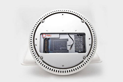

Have you tryed resetting the PMU? Remove the bottom cover and located near the lower edge of the AirPort card connector.
With the unit not plugged in, push that button once. Then plug in the AC cord and press the startup button.
