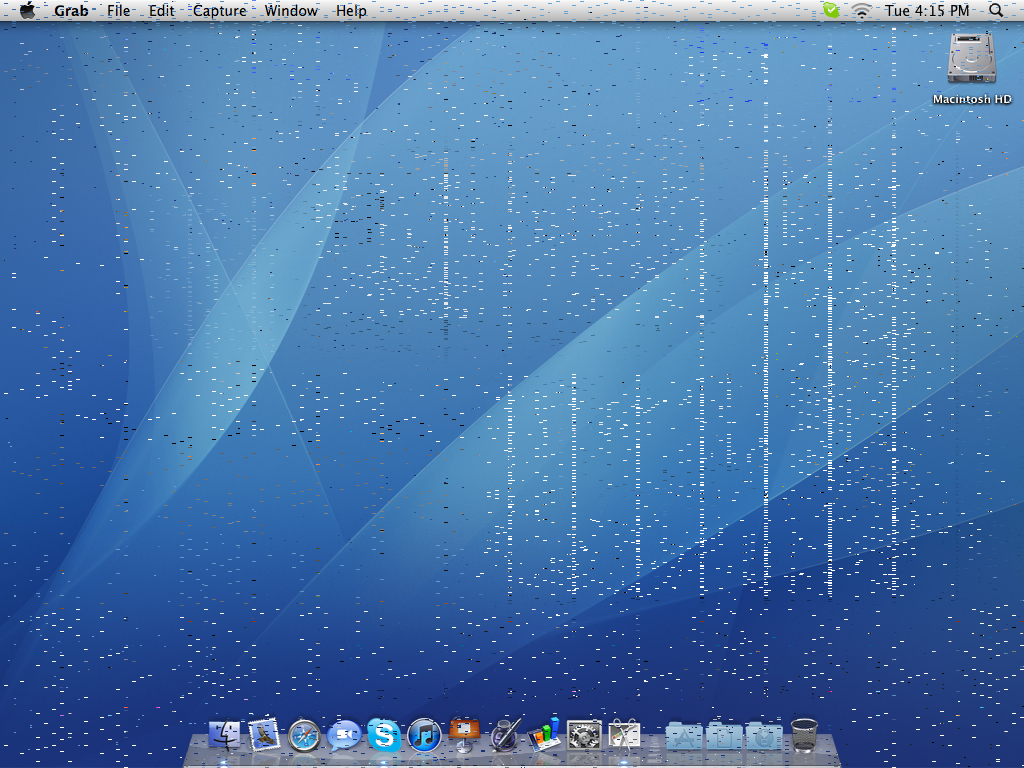

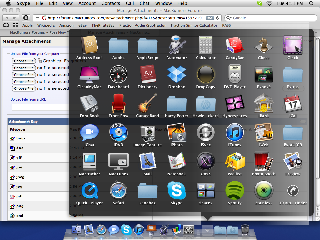

Hi MacRumors!
Glad to have found a PPC-specific section of your forums, I'll jump right in!
I have an iMac G4 (and it's a beauty 😀), 700MHz, 1GB RAM, 160GB HD (all upgraded, but sadly CPU/GPU are soldered 😱), and I've done a clean install of Leopard on it, and updated everything. Now, I have literally taken long hours to find an answer for this, and it's simple. Before the Leopard Graphics Update 1.0, the Stacks and Folders opened fine, but when the display tried to sleep, it just went to full brightness; a frozen image of the desktop. It also slept fine. When I updated it, the Stacks and Folders had weird graphical lines and artifacts around them, and will never go away. The display sleeps fine, but waking from sleep every once in a while will bring my display to hell. Not a white screen as commonly disputed, but thousands of graphical artifacts just cover the display, and only a restart will fix it.
I've reinstalled, reset the PRAM, PMU, restarted, even done this weird trick on Apple Community Support were you replace the Leopard drivers with Tiger ones, but that made it worse. HMMMMM 😡. What can I do? Has anyone made a script, found a solution? ANYTHING? I certainly can't find anything anywhere. I have attached a photo of my 'display hell.' (and messed up Stacks) Please help if you can! Thanks a ton.
Noah
P.S. I will regularly check and respond if you have questions/ answers!
P.S.S. This is my main machine! I cant go back to Tiger, what with even worse compatibility on a already-outdated PPC machine.
Again thanks! 😎 :apple:

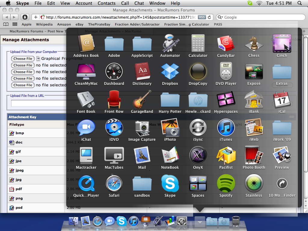

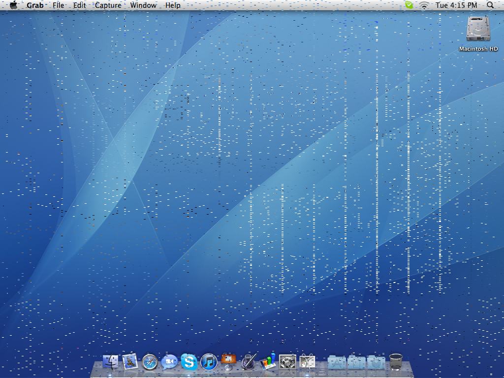

Hi MacRumors!
Noah
Looks like a Graphics driver issue, it's probably overheating, have you checked the GPU temps?
A bad PSU can mess up graphics cards as well.
There may not be a good fix for this.
Leopard isn't officially supported on you iMac. It requires an 866mhz cpu.
So i'm guessing you use leopard-assist or some other hack / work-around to get it installed.
There are some tips (search the forum) for running Leopard on unsupported hardware. There are features you can disable (i think spotlight, icon animation, menu bar transparency, etc) that are supposed to help it run.
Good luck!!!
That screen could be caused by a burnt GPU chip or unstable power supply. But let's hope that it's caused by that Leopard Graphics Update. I've installed Leopard on the 800Mhz 15" G4 iMac. Same model as yours just slightly faster. I just tested its sleep and everything is working correctly. My suggestion, reinstall Leopard but don't install the Leopard Graphics Update.
Good luck!!!
Running Leopard on non-876Mhz+ Macs doesn't have incompatibility problems unless you install it on a PCI Graphics or Sawtooth PowerMac G4 with the ATI Rage 128 card. That's the only G4 era thing Leopard doesn't have drivers for. It runs just fine on anything else with enough ram. The OP's iMac has a GeForce2 MX, which Leopard has complete driver support for.
Response
Thanks for so many fast replies!
The GPU is cool, and my dad's PowerBook G4 has the MX2 GPU (with a 1GHz chip), so it's not incompatibility. Again, without the Graphics Update, I cant even sleep the display properly 🙁. I'm damned if I do, damned if I don't. So... What's left? I can't leave it. There has to be SOMETHING going on... Oh, and I disabled Dashboard and other stuff to help keep stress to a minimum. It shouldn't be stress though, as normal things (Pages '09, even GarageBand '09) run very well, especially considering my configuration. I'm pretty sure the power supply was actually replaced, so I'm stumped.

From your screen capture, it looks more to me like a loose fitting memory chip, or card, where an address line is not making a clean connection. This reminds me of discussions I had with other servicing outfits when I talked with their technicians. The G4 is very particular in the system RAM it uses (characteristics). One outfit, that I highly respect, refuses to warranty systems where the system RAM is not Apple, or RAM not originally installed by them; where they control the quality of the RAM being installed. At the time, my impression was they were talking specifically about the G4 systems. If it isn't Apple or theirs, the first thing they do in troubleshooting is to replace the installed RAM with RAM they trust, then start troubleshooting if the issue remains. In reading other threads, I have discovered that there is some borderline RAM out their that seems to operate fine in the first few months then after sufficient burn-in, and timely usage (till after warranty) the RAM timing characteristic drift slightly out of tolerance for the G4 needs, resulting in intermittent errors and corrupted files.

I know I'm really late to the party here, but I think I know what part of your issue is:
When running newer versions of Mac OS X (Tiger and Leopard), the iMac G4's GeForce4 MX GPU is not capable of Core Image rendering. This causes some minor graphical issues. One such issue would be the lack of the Dashboard ripple effect when a widget is introduced. Another would be an opaque menu bar in Mac OS X Leopard.
I believe your issue stems from the fact that your graphics card is incapable of Core Image effects, and that includes opening/closing Stacks.
The stacks glitch is caused by lack of Core Image, but the second picture is caused by a failing GPU.
