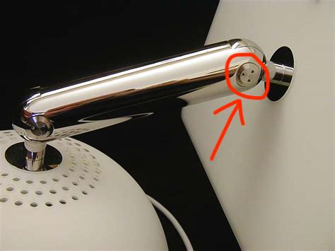

I've found that it's posisble to re-tension the neck by using a long, thick screwdriver through the screw hole in the neck and using it to lever the spring back under tension. I tried to brute force it for a while before that with no luck, but the screwdriver technique was super easy.
Ok, that sounds like something I should try, but I am not sure which screw hole in the neck that you are referring to?
The main two screws which hold the neck together.
When these screws are out there is a reasonabe sized hole which you can fit a screwdriver through, you should then be able to use that to leverage the spring back onto the part that they sit on when under tension.

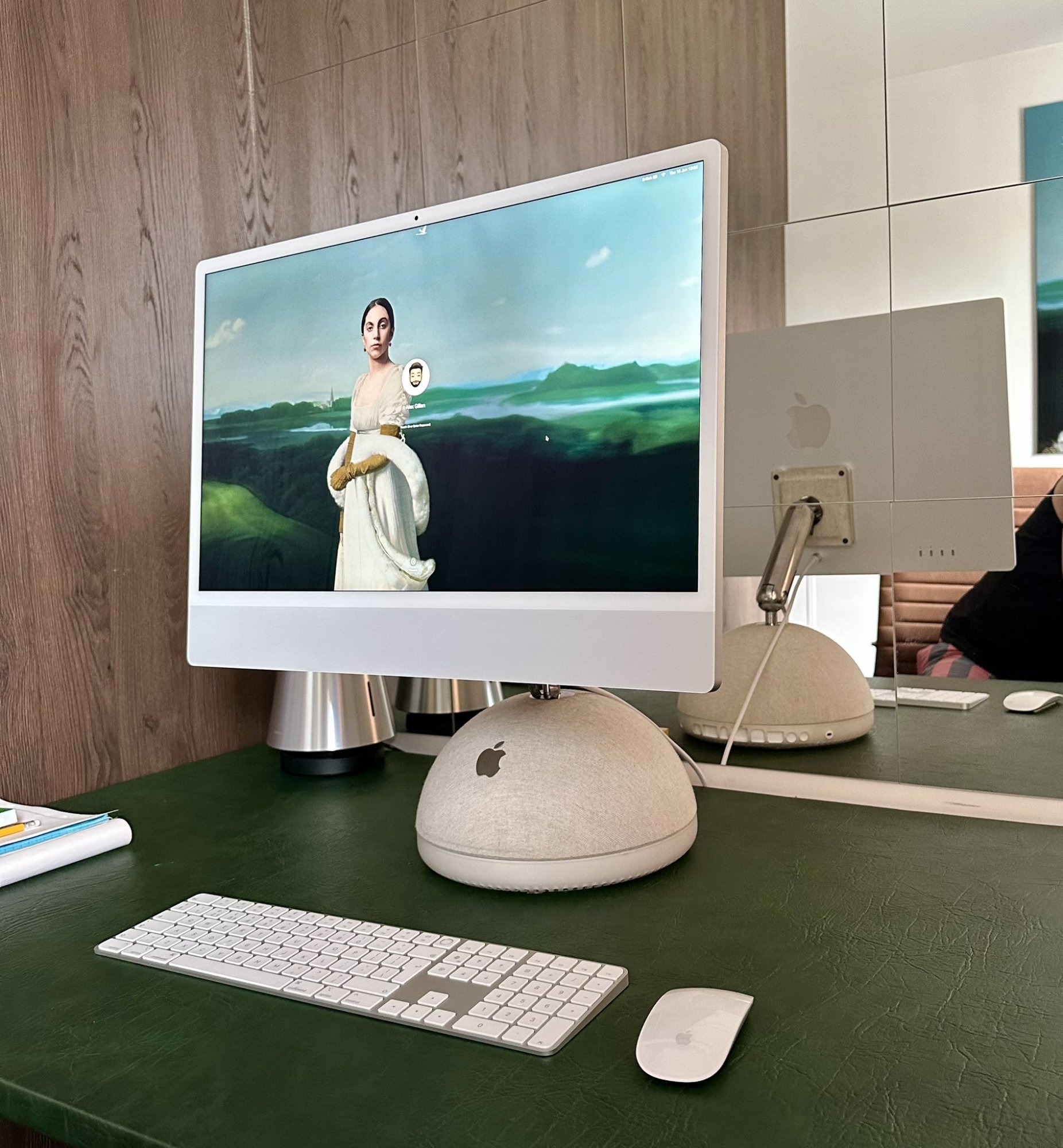

I got inspired by the people who added the Mac mini m1 inside but I didn't want to mess with soldering and stuff so I got an iMac M1 visa and adapted it to the neck of the iMac G4. My base was too damaged so I added a speaker fabric around the base. the movements are a bit limited as the neck is from a 15" iMac but I managed to add some filler gouges to support the hight at a stable level.
This looks... interesting 🤔
Great it worked but I wouldn't go that way as the untouched exterior of the iMac G4 is as beautiful as is and it doesn't discover the sleeper but if you have an unused damaged base and a spare iMac M1 then why don't try it this way. I'd cover the cable somehow.
