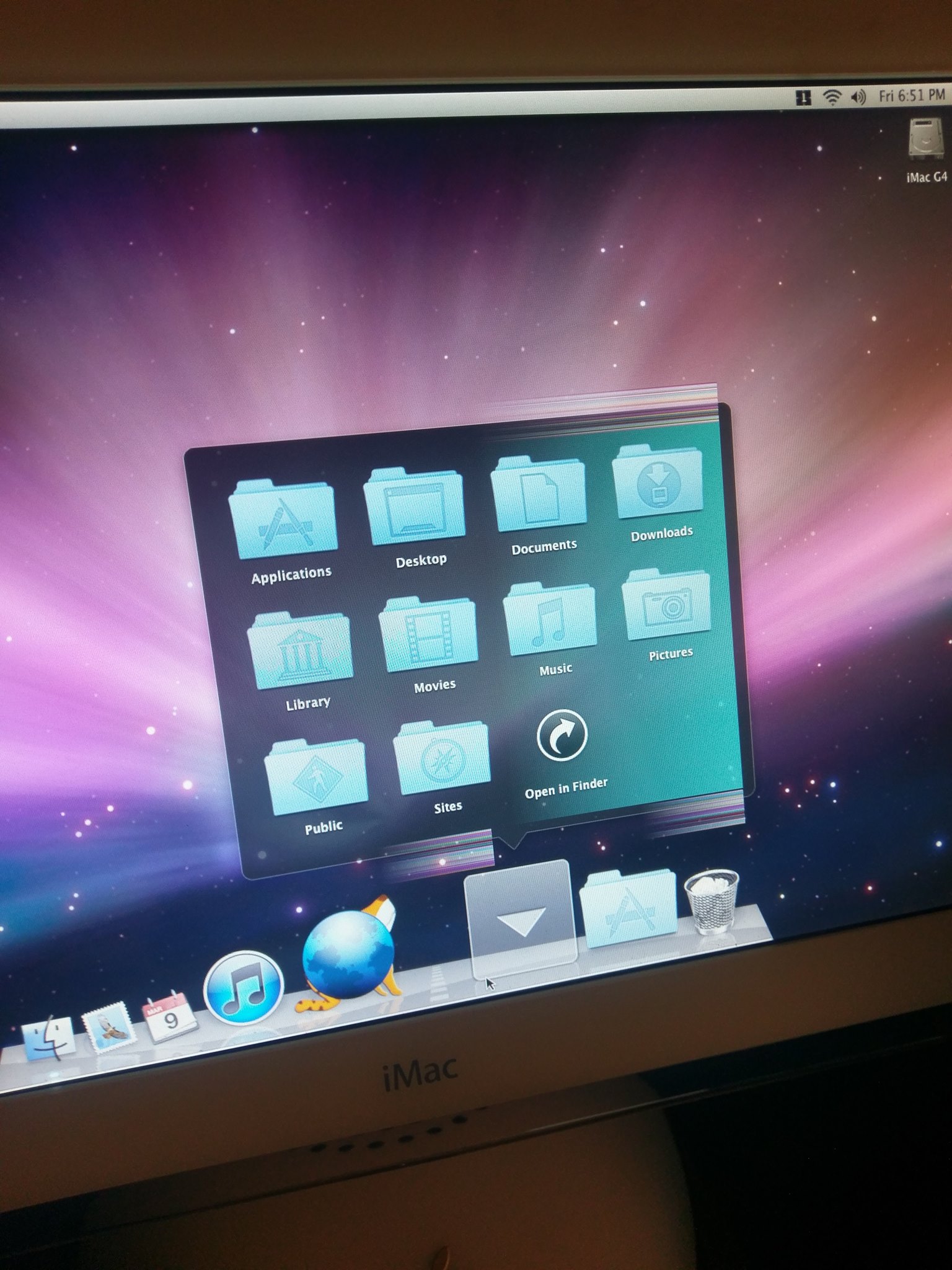

I keep having weird issues with the graphics, geforce4 MX 64mb. If I have a folder in the dock it does not display properly, see the attachment. The dock is slow in general but I assume thats because its only got 768mb.

Interesting glitch on the dock. The only time I have seen this in Leopard is when my G5’s Radeon 9800 GPU overheated and began to fail. Does the glitch appear consistently?
In terms of the game performance, can you try installing 10.4.11 on the G4 to make an equal comparison? There should be no reason for the 400Mhz G3 to outperform the 1Ghz G4 unless there is a hardware failure of some kind.
If you take out the ram module you added, do the performance and glitches resolve?
I suspect it's because your GPU isn't Core Image accelerated - I used to see similar errors when I put Leopard on my 667Mhz Powerbook, even my 1.42Ghz Dual G4 occasionally glitches when Leopard does some fancy transitions.

I thought about trying 10.4, I'll target boot the G3 and see how that goes.
The dock glitch is always there, even after being powered off for awhile. The ram stick I added is the internal one thats a pain to get to, so that was going to be my last resort.
In regards to that, you might be correct but I also have an ibook G4, 12" 1.33ghz. It has 512mb and runs leopard without any graphic issues aside from being slow and out of ram. It's GPU is a Radeon 9550 with 32mb.

I have the same model iBook and that GPU is Core Image supported. I'm not saying the issues are definitely Core Image related, just that I've had exactly the same issues running Leopard on "pre-Leopard" hardware.

I just pulled mine out, you're right. I didn't realize the 9550 was actually more powerful, despite its lack of vram. It very well might be a core image issue.

It's likely lack of Core Image support. I get various UI glitches with the dock on an unsupported 667GHz TiBook running Leopard on an original Radeon GPU.
