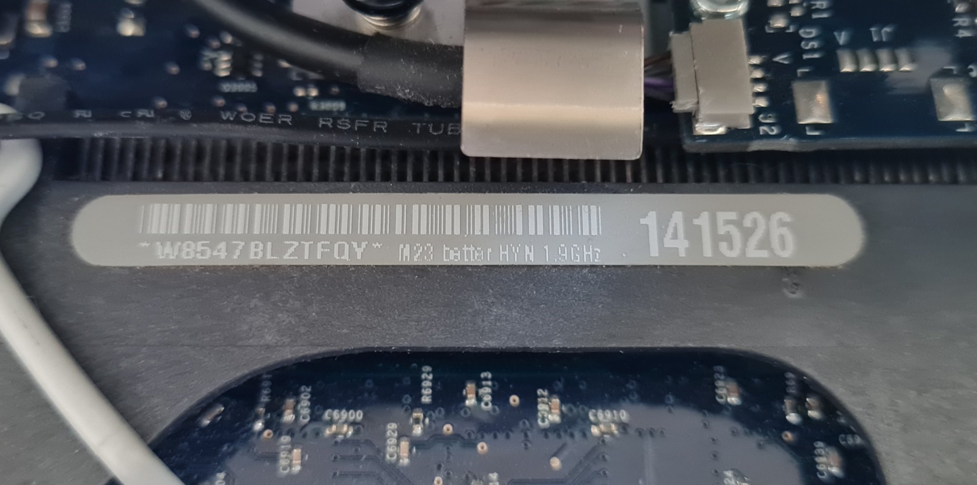

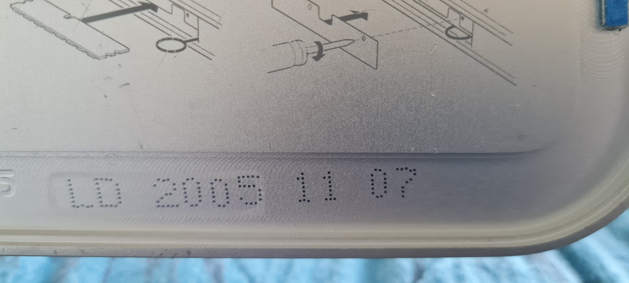

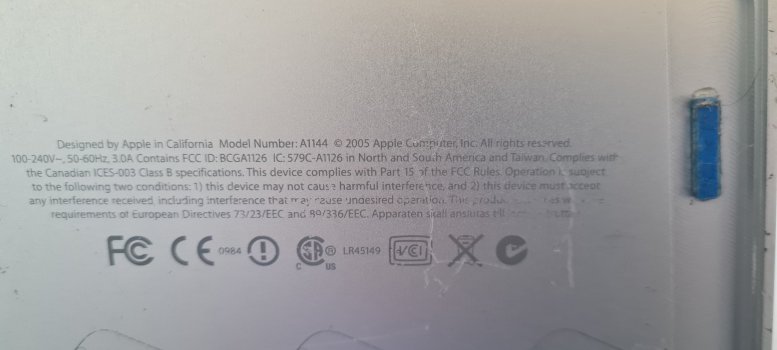

Hi, thanks for your response. I am still confused. As mentioned the 240 pin didnt fit in and I know how you can insert memories (knowing about the lock). Please can you have a look at the image I shared. Underneath the stand you see 2005 / 11 / 7 - Model A1144 - In this manual (https://tim.id.au/laptops/apple/imac/imacg5_17_isight.pdf) , they are talking about 184 pins Memory....So, I still dont know if the one I have is an earlier model as you mentioned (which have 184pins). Issue. I really dont like to buy again incorrect RAM's - Thank you very much -

The service manual mentions 184-pin DDR1 but other sources (e.g. EveryMac, Mactracker, PR) mention 240-pin DDR2. How many memory slots does your iMac have, one or two?

According to the DDR Wikipedia has 184 pins vs DDR2 240 pins. Other members gladly pointed that other information sources are more reliable than official Apple docs. Because like I mentioned we tested in our iMac G5 that support without incompatibilities and errors DDR2 4Gb sticks and even above speed.
I love the external design of those iMac G5 series, but in the maintenance, I really curse and hate every engineer that was involved in the redesign of this lineup, because the first generation of iMac G5 was a easy/pleasure to open, but this iSight it's a pain, and I know that the RAM replacement isn't "easy", but if you have the ring tabs properly out and insert correctly the RAM module it would fit.
Like I said in that thread it would fit any DDR2 modules that I tested (I used "PC overclock RAM", but the heatspreader won't fit, then I carefully removed and no problems), so no need for any "Apple Special part/component".

I don’t own a 17” iSight. But as others pointed out, it should take the same DDR2 memory as the 20” one I have.
