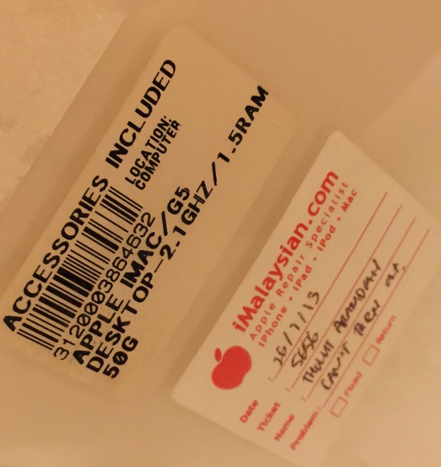

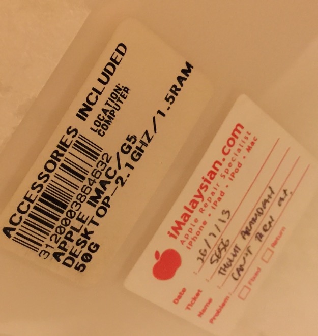

I got hold of the G5 yesterday, did not dare boot it, fearing it would trip the elcb and me ending being the target of fury of my family who were asleep!
Tried b4 leaving for work today .... Now the G5 does not respond at all! Maybe the techs who inspected it has meddled with it !
The service sticker from 2013Is still intact.
So.... Now i have been left with the option of a psu failure or a dead logicboard.
Seriously .... I hv never come accross a dead Mac logicboard! So i dnt know how it would react.
Would a Mac with a dead logic-board still hv the fans spin ?

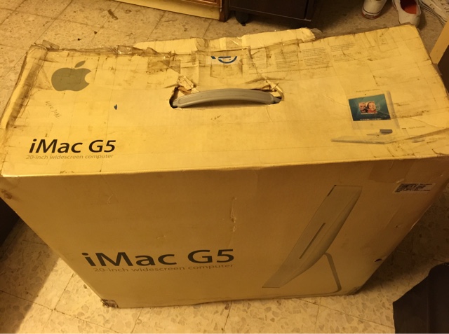

Oh dear.... Not the caps or the logic board. I can still live with it if its the psu !
The G5 came with e original package, except for the remote and manuals...
So e Ac cable was e original, but when i tested it today morn, i used an original apple power cord of an imac g3.
