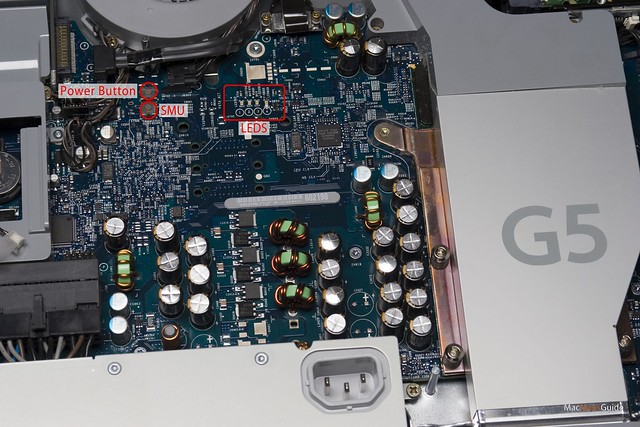

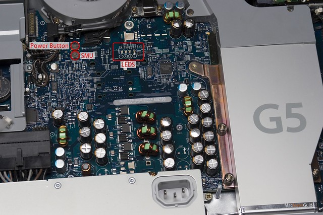

I have the same machine. Maybe once a year, it behave strange, fans at full speed, or random crashes.
It's easily fixed by a SMU reset , pressing this button :
The fact your crashes when putting into sleep mode makes me think of a power management problem.

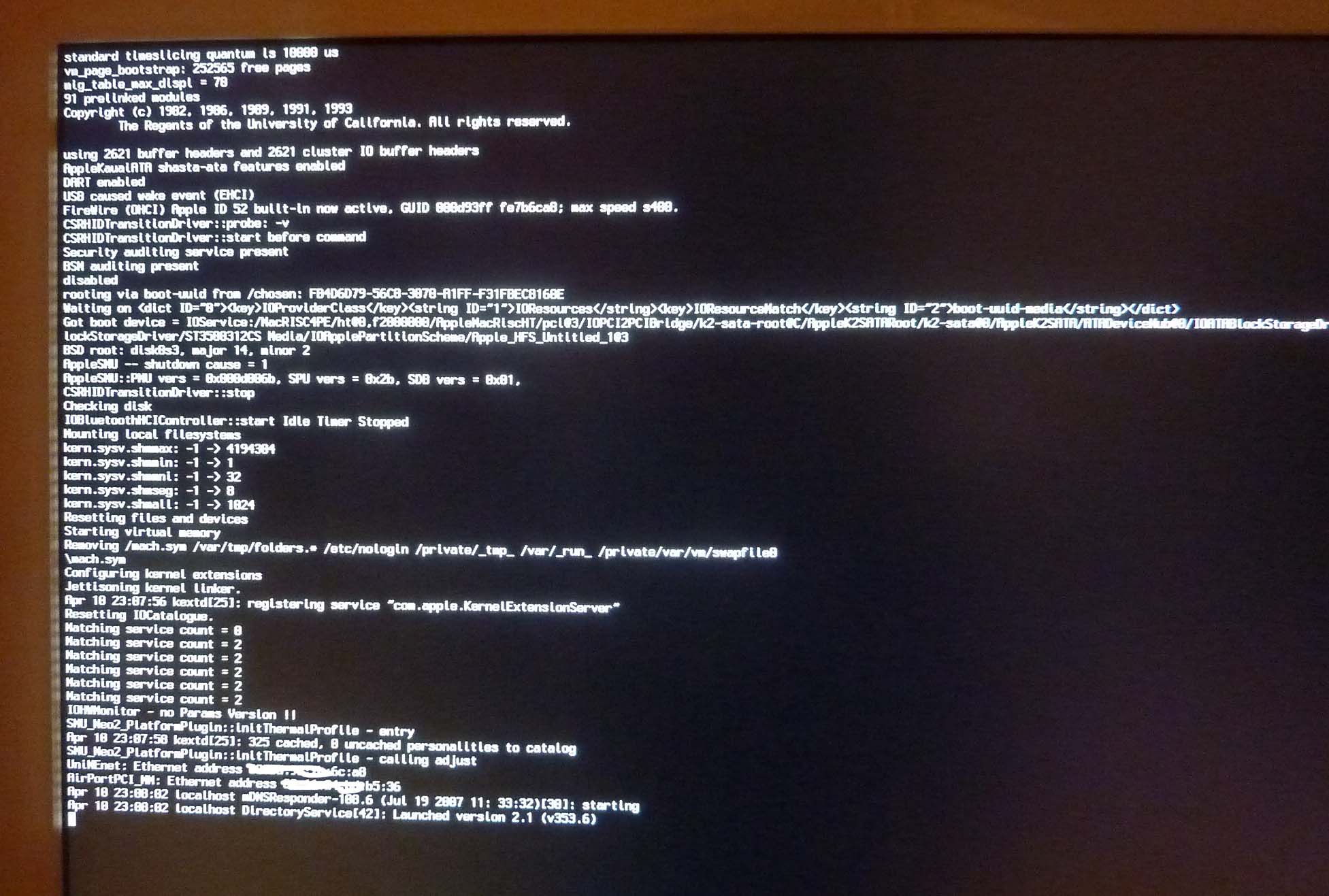

I booted in verbose mode and got a screen full of code and printing, none of which meant anything to me, so no wiser really. It didnt even stay there long enough to read properly before the imac continued to boot normally to desktop.

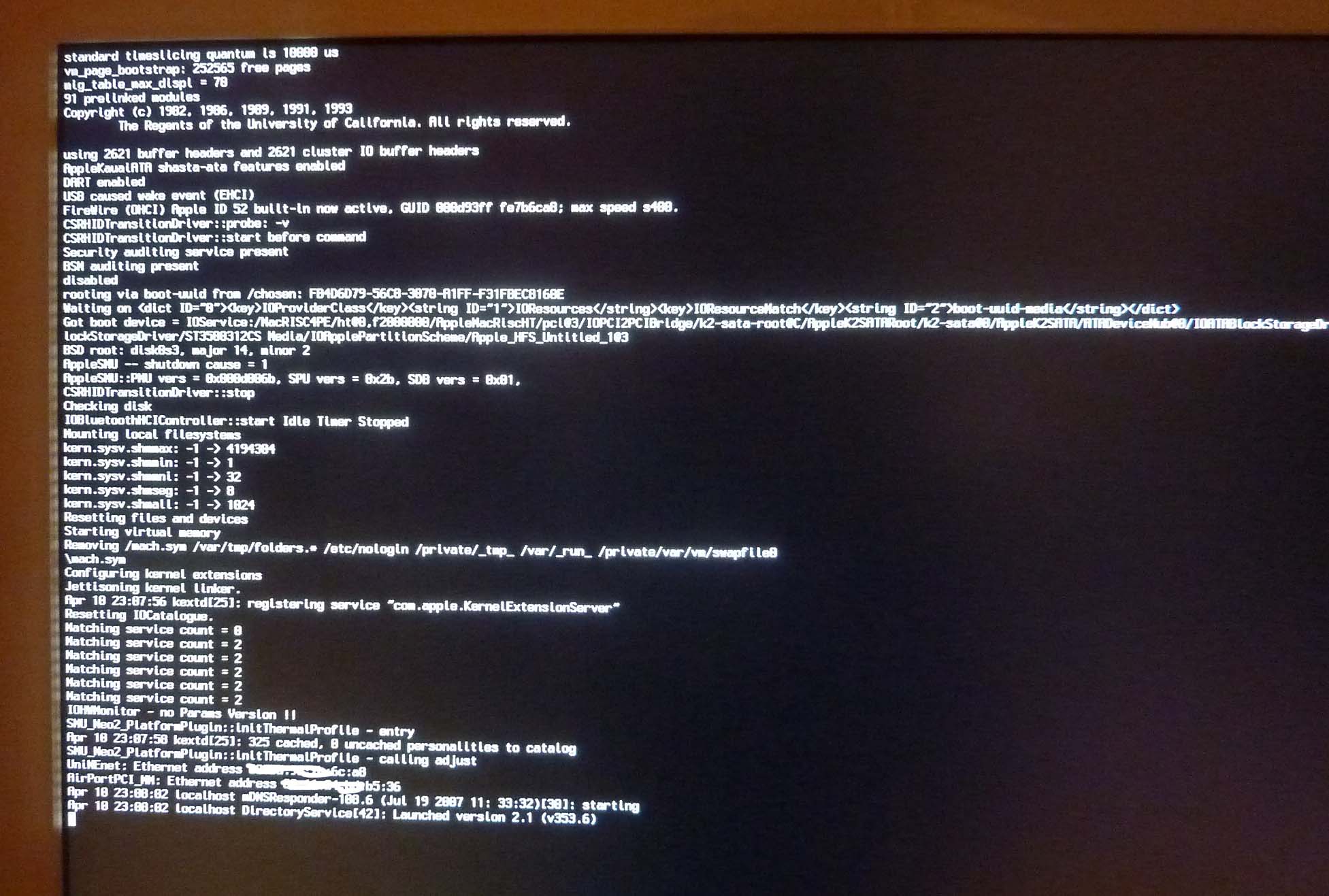

That’s what it’s supposed to do, and unfortunately, no, it doesn’t stay up on screen for long. It definitely helps to spot places where it shows loading errors (like kexts), which means having prior familiarity with OS X’s boot process. I suggested the idea with the understanding you were familiar with OS X on a level on par with, say, the skill of swapping out board capacitors (something I’ve never had the courage to do!).
Er - no. I'm a clockmaker. I can do any fiddly delicate repairs, but I don't understand computer code. I could try getting a screen shot and posting it on here to see if anyone can throw some light on it.
You could record a video of the process and watch it in slow motion.
Well Galgot was spot on. Resetting the SMU solved the problem. My Mac now fully boots in 40 seconds and the Firewire, Airport and Bluetooth are now recognised. It also sleeps and wakes as it should without crashing. Useful information as it's such an easy fix. Not quite the same G5 model though. The picture shows a first generation iMac G5 and the SMU is reset by pressing the button shown. Mine is a second generation iMac G5 ALS - it has no reset button. The SMU is reset by removing the power plug and after 15 seconds replacing it while the power button is held pressed. Then press the power button again to boot normally. Don't even need to open the case!
