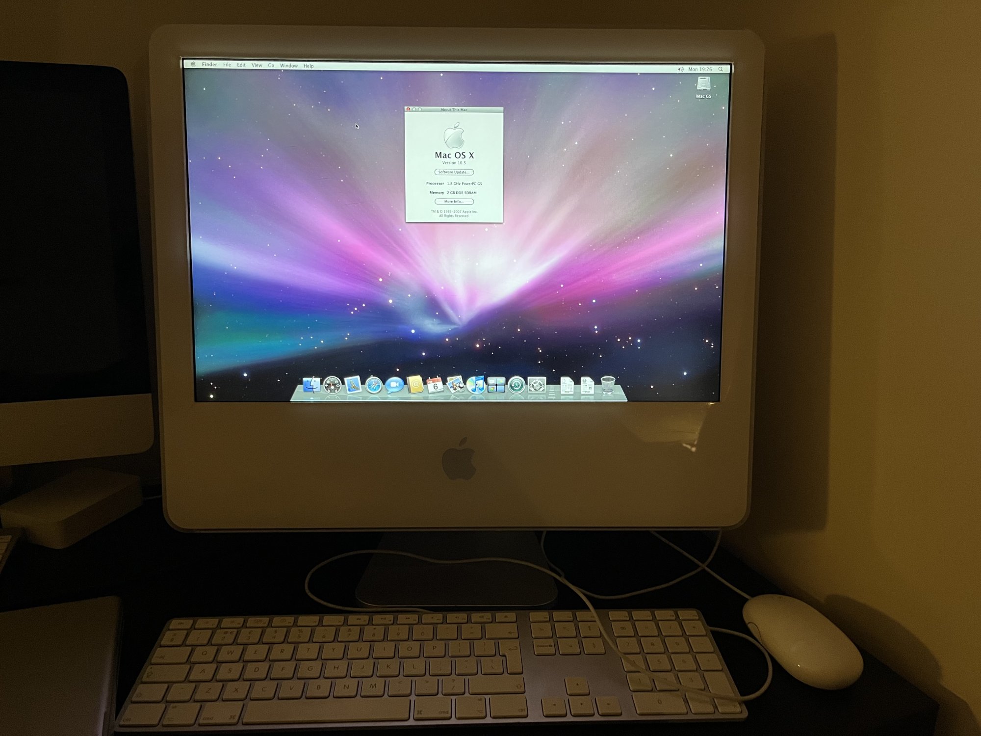

Hi all,
So my new £10 iMac G5 is working a treat…with leopard 10.5. If I try to upgrade the OS to 10.5.8 (or 10.5.Sorbet), the initial boot works, but after restarting the computer, it chimes, I get a grey apple loading screen - and then an abrupt power off.
I’ve popped in a new PRAM battery, reset the PRAM, tried safe mode… I’ve even tried substituting some 10.5 .kext files relating to power management in 10.5.8. The only thing that resolves the problem is reloading the OS to stock 10.5 - which I fortunately have on DVD from my own original purchase way back when.

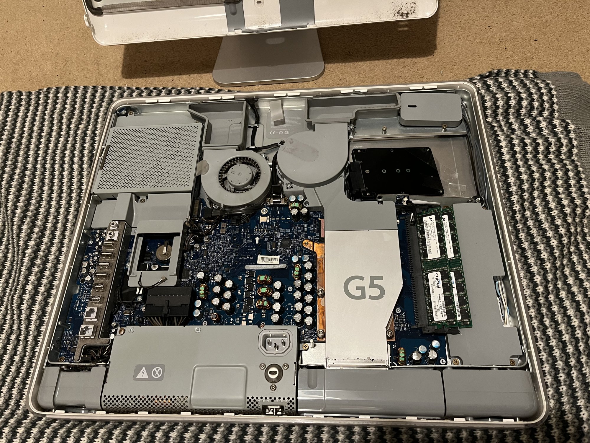

The capacitors look good. I’m going to try and decipher the LEDs on the logic board, that describe (I think) the status of the SMU.

I have an iMac G5 that shuts down randomly regardless of the macOS version - Panther, Tiger or Leopard. Very helpful souls looked over photos of the logic board and determined that many of its capacitors are shot.
The capacitors look good...
Ok but it's worth pointing out that the people who examined the logic board photos for my iMac G5 drew my attention to the fact that its capacitors also seemingly look good but under close scrutiny they are exposed as slightly swollen. There's a possibility that your machine might have the same issue. Going on my experience, I'd urge you to inspect the caps again.
You’re quite right - visible in the photo above, you can just see that one of the capacitors on the bottom right of the logic board is not like the others. Slightly swollen, with a central dark pinpoint spot. Oh dear.
Anyone fancy a recap job?
Don't despair... It wouldn't be difficult to pull and replace them. (Even if only one is afflicted, I'd remove the whole lot as a precautionary measure to save yourself having to go back in and deal with the others later when they fail.) I've bought capacitors for renewal/overhaul work on my 80s computers and they were cheap, plus the Mac only cost you a tenner anyway so it's hardly money pit territory. 😉
The only reason that I decided against repairing mine was that I'd also need to replace its destroyed LCD and I didn't think it was worth it. Yours on the other hand is in much better condition.

You could probably do this yourself with a suitable desoldering gun. I won't volunteer because I don't want to be blamed/excoriated if I botch something! Are you confident with soldering or would you be willing to learn? If so, think it over as it could be a fun project. If I was you with a machine in that condition, I'd consider tackling it. 🙂
