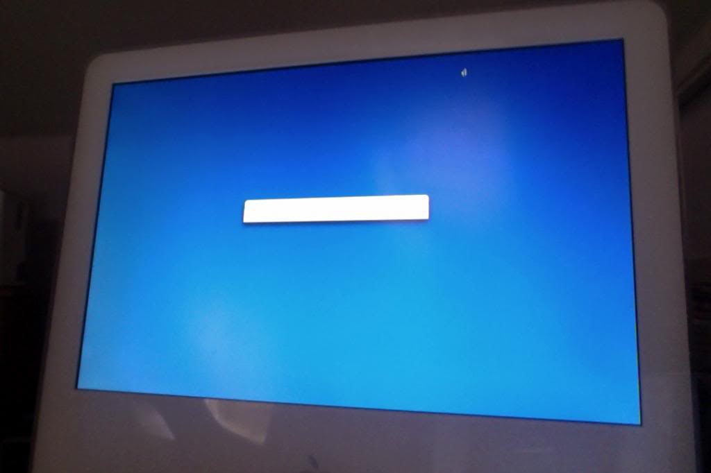

Then I was in the middle of something and the iMac just turned off randomly while in the user menu. When I tried to reboot it gets stuck on the blue screen with mouse but its different from every other blue screen that people get.
It loads the grey box apple screen then it goes into a blue screen and a apple grey box pops up for about 3 seconds with the Mac OS X screen then it goes into the blue screen like this :
I can move the mouse and the box around but thats as far as it gets.
It just goes to a darker screen after 10 seconds then the iMac goes to sleep.

If you hold Command and V keys at startup, where does it stop, it's verbose mode.
Code:
March 14 15:06:15 ........firewire something....
Starting Virtual Memory
It runs through too fast but thats the last thing its says then goes back to the screenshot I posted

I reread your first post and you say:
So I used the single user mode to try and reset the admin password I tried a few different things but nothing seamed to work.
What did you do, did you remove the AppleSetupDone or reset password, if so it's probably hard to recover from this and you need some kind of installer to get out of this situation.

I tried both the password reset wouldn't work but the AppleSetupDone command did.
I saw more posts here people removing/deleting that file and got stuck, the problem is that there is no user to login now, it does not seem to work or not work well.
The way out here is probably a reinstall, if I were you I would just get it on the net if I were you.
