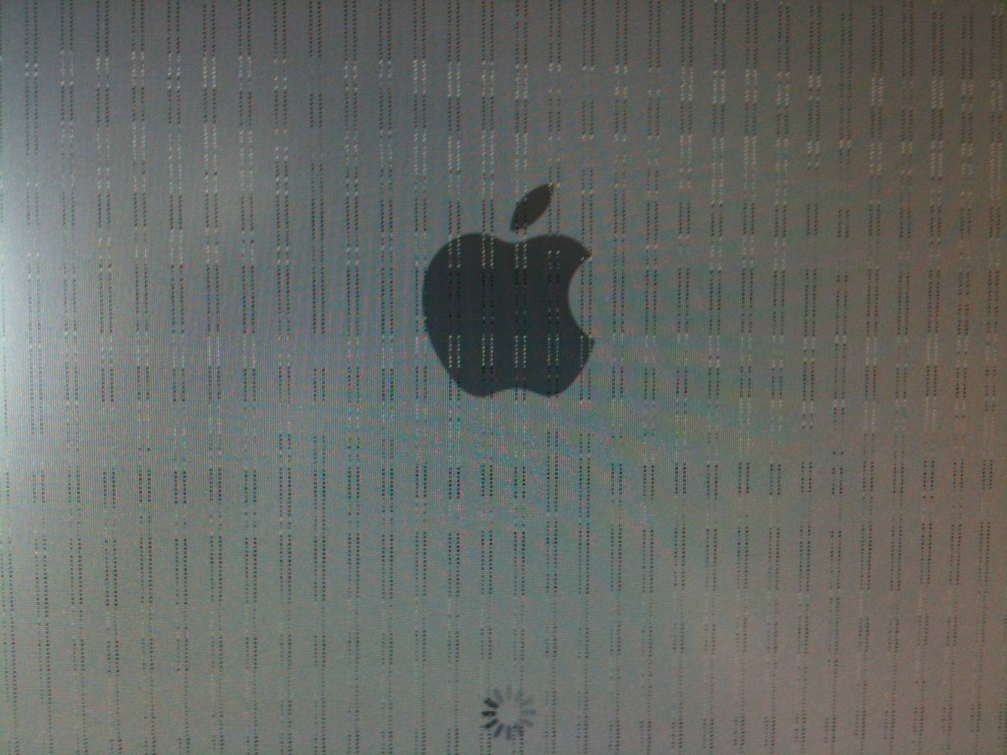

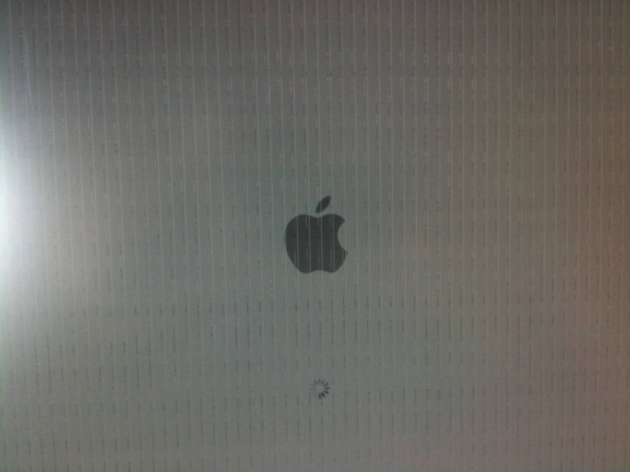

I have a 1st generation iMac G5 (17 inch, 1.8 GHz) which does not boot up...
it chimes, the gey screen with Apple logo appears (with artifacts) and it freezes before completely loading the OS... I have reviewed some of the threads regarding iMac G5 issues, but none seem to describe this issue completely... I understand that common causes are either the caps or the GPU, just wanted to check if someone has had these exact symptoms and what the cause was...
here are some stills of what the boot screen looked like:
thanks in advance...
Open it up. It was easy to do on this iMac. You can visually examine the capacitors (they bulge out if bad) but my money is on the GPU. Can you boot off a system disk?

Doesn't sound like either of those.
You are right, the boot disk was actually my powerbook in target disk mode... the question mark folder appears, it then recognizes the powerbook drive and starts to boot, until it freezes...
I did open it up to examine the caps, but found no obvious culprit... there is one questionable cap that may be somewhat bulged, one of the four 1000uf 16v caps.
I may try to change this cap first, to see if that fixes it... if not it will probably be the GPU, or is there some alternative cause I am missing?
If you're in there, change all the caps. If one is bad, the others are from the same batch and will likely follow. What you're seeing on screen looks like what I saw on another old G5 iMac when the caps went.
Ok, good to know... hopefully it will be just the caps, I don't really want to have a go at the GPU with the heat gun!

GPU ! my G5 has the same issue
replaced all capacitors, bur stil the same nvidia issue
tried to re-heat gpu- dont work
I would have to say...
GPU for sure.. sounds like the iMac is overheating or there is the possibility of your capacitors leaking onto the GPU chip which could be causing this.. or if not that, then the GPU is starting to go up and the only way to fix that is a new logic board..
At that point you can decide if its worth it.. Personally, the iMac G5's had so many problems that many just replaced them with Intel iMacs.
