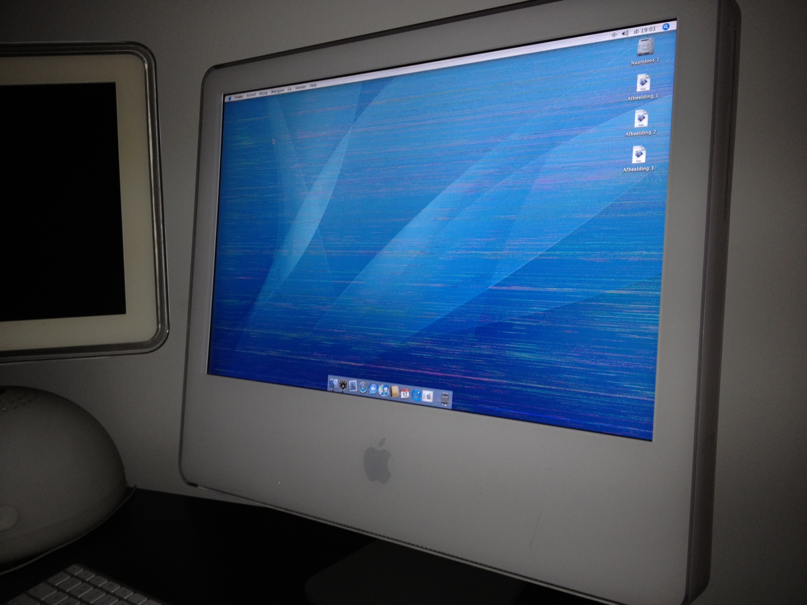

My iMac G5 1,8Ghz appears to have some very weird problems.
First, when I press the power button it will give the sound and eventually turn on the screen. It will boot but after 10 seconds, it turns off. So it still turns off at the boot screen with the logo!
After a PRAM reset (1x), no luck.
BUT, after a PRAM reset (wait for the 3rd restart) it boots!

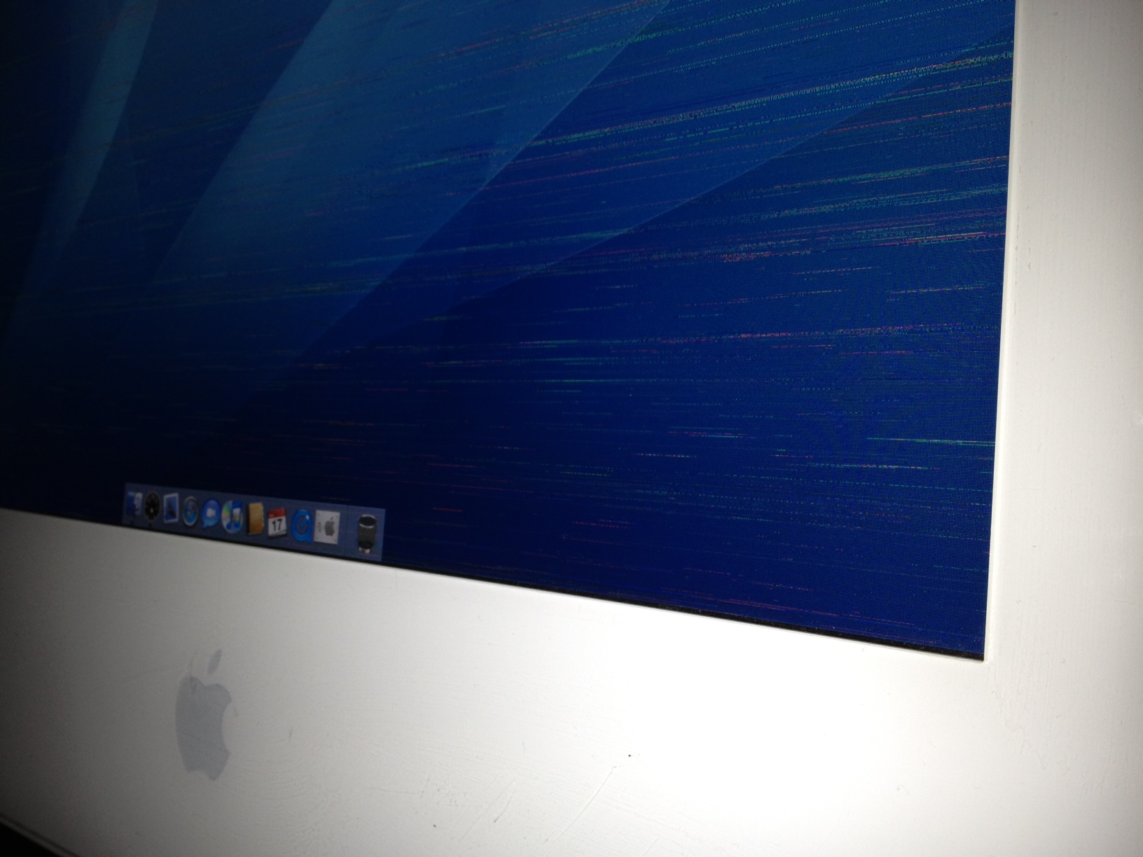

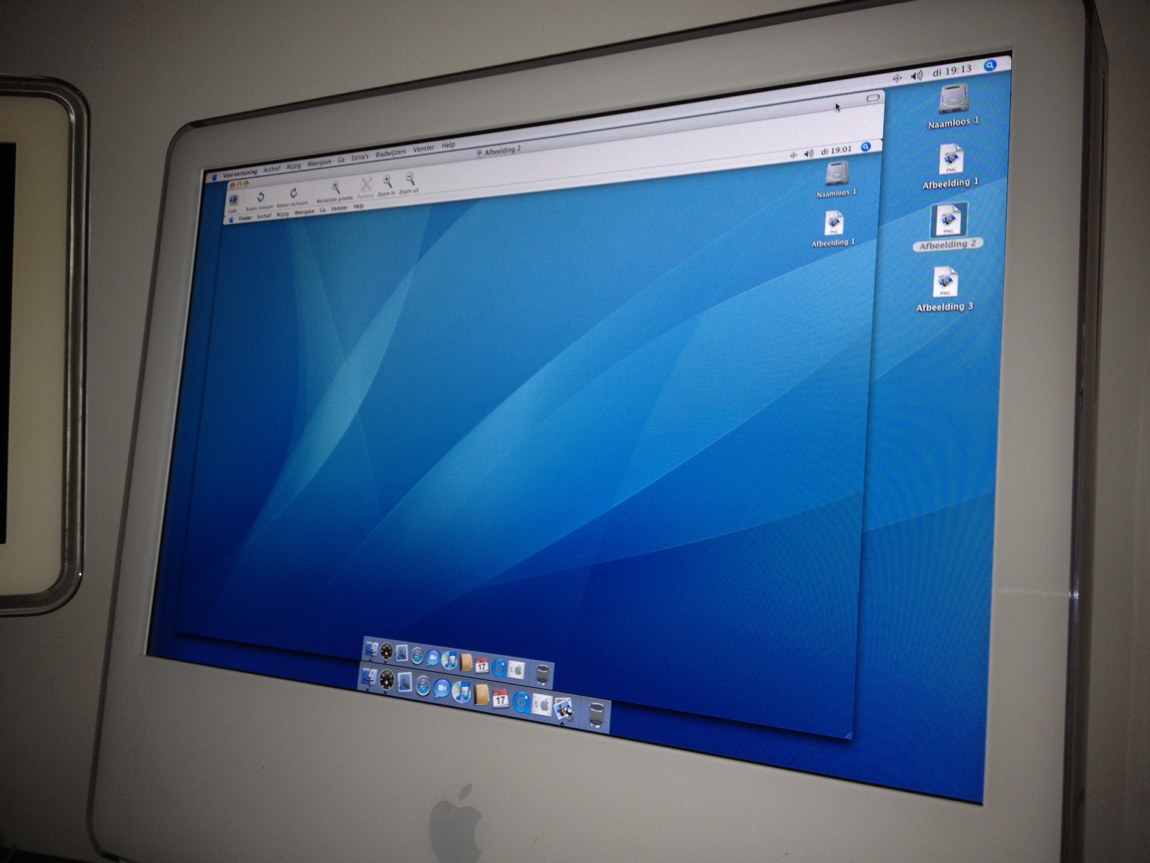

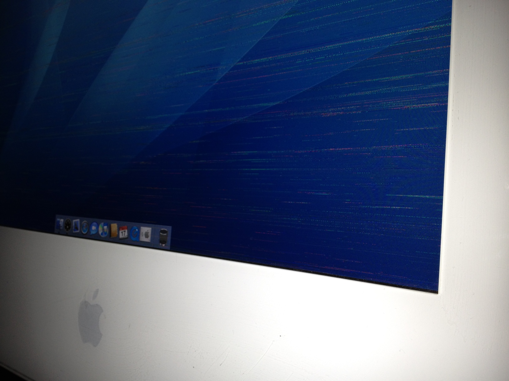

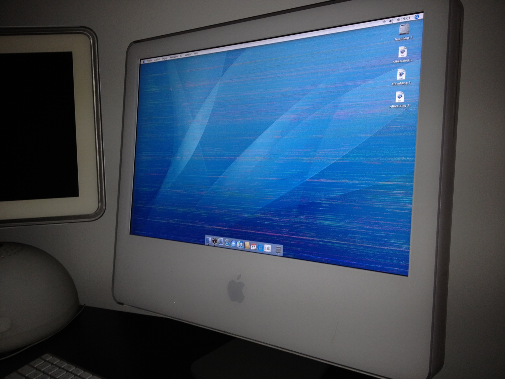

It boots into Tiger (new 2TB HD, fresh install). But, it shows these lines real bad as if the graphics card is failing. Also, this fades away until is normal!

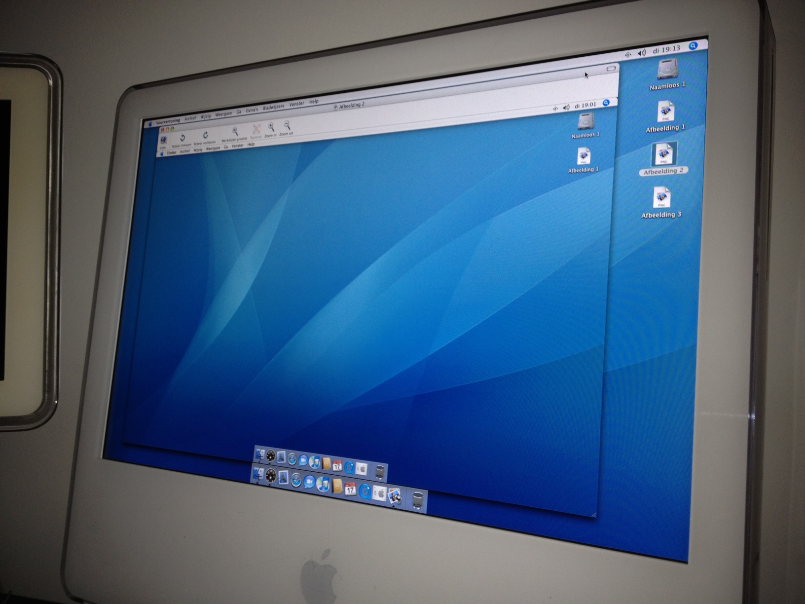

When doing a screenshot, is shows no lines. Perfect screenshot.
At a reboot, it boots without doing anything.
But when it is off for a while, same problem persists.
What can be wrong?
Facts:
- Boots after 'all hardware reset --> alt+cmd+p+r till 3rd reboot"
- New 2TB HD (old one crashed)
- Weird Graphics card like issue at boot (when it boots)
- Issue fades away till normal behavior
- Screenshot shows no interferences.
See pictures for further details! Screenshot was taken when heavy screen distortion occurred.

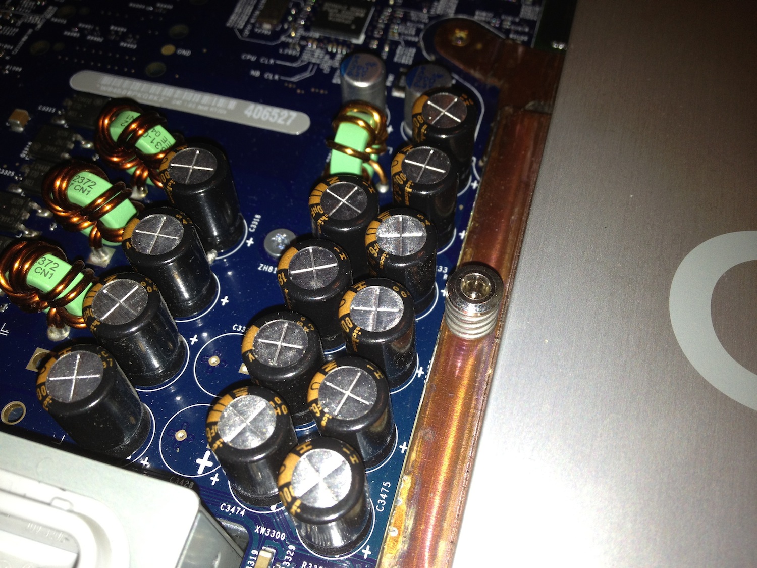

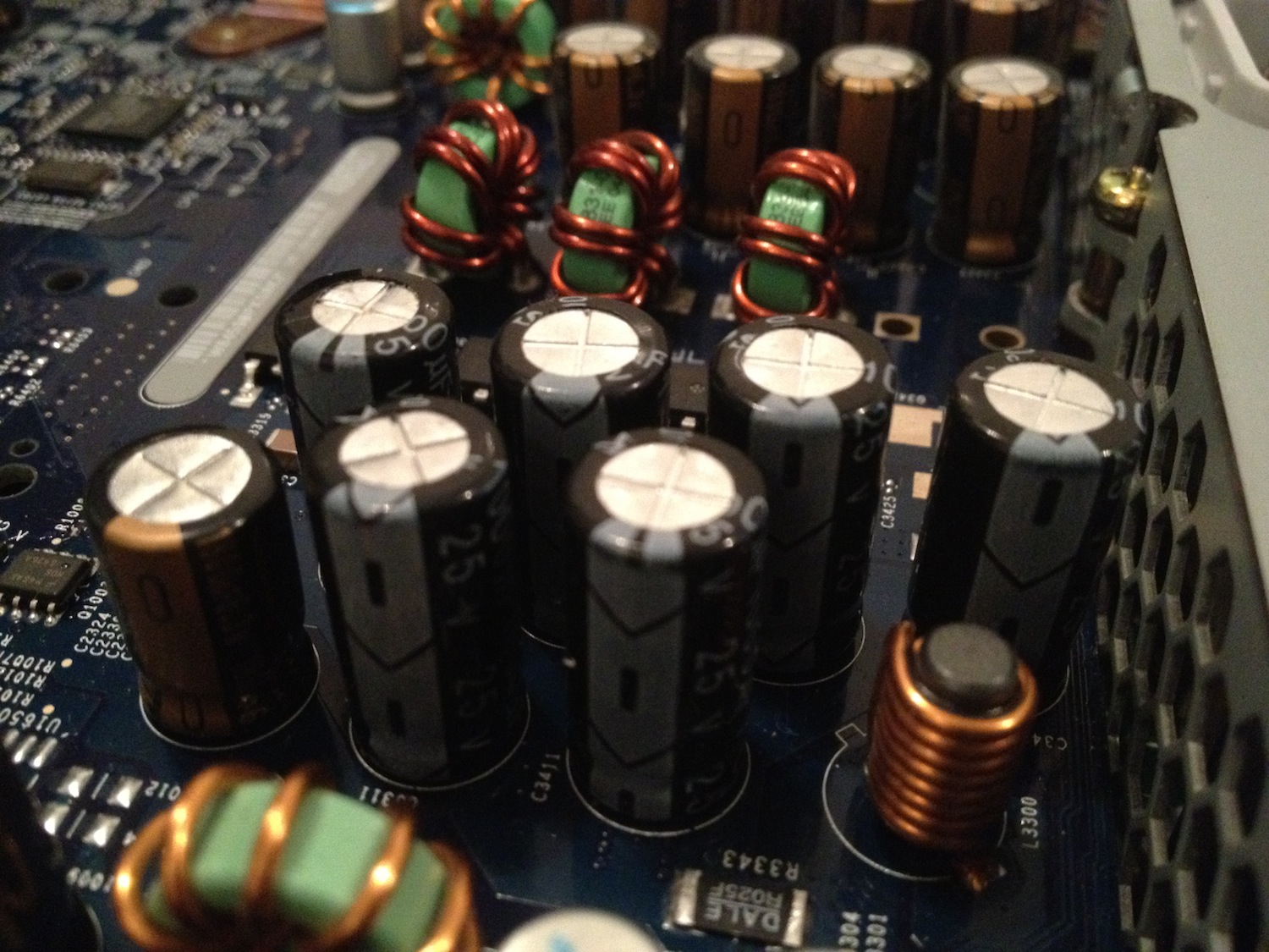

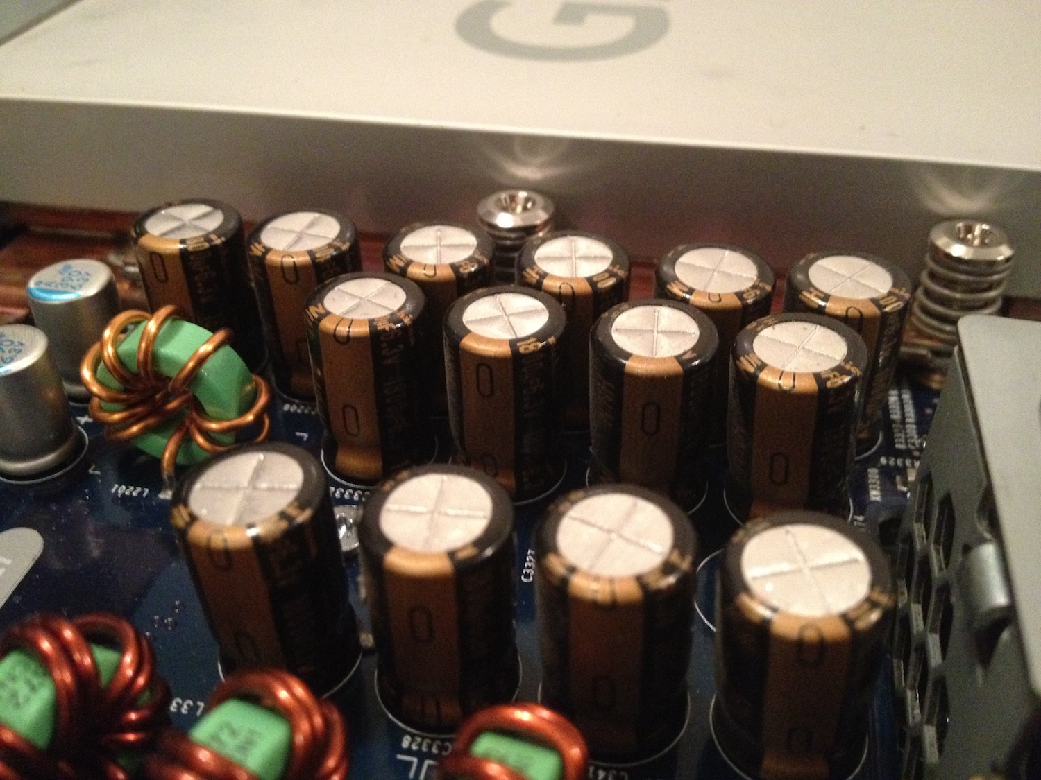

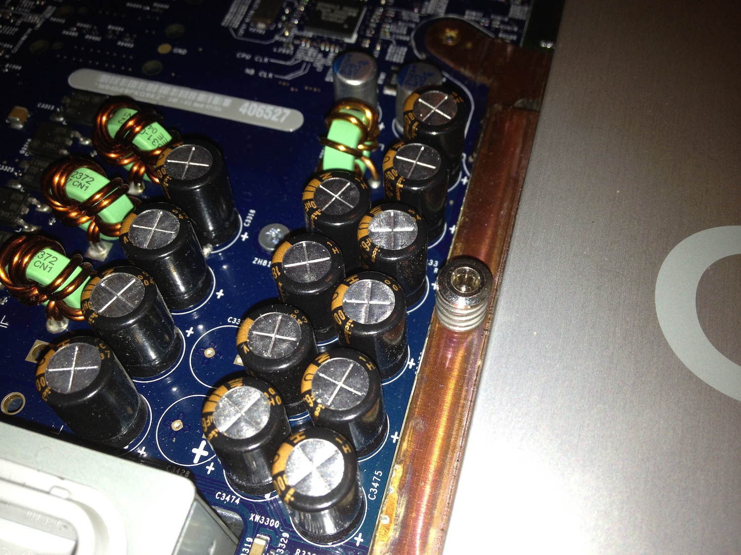

Have you inspected the capacitors on the motherboard? There are quite a few and are know to leak/blow.
I have fixed a few dead G5 iMacs by replacing the caps. Unfortunately, it requires removing the logic board.
Take another picture with the back off and we can tell you for sure.

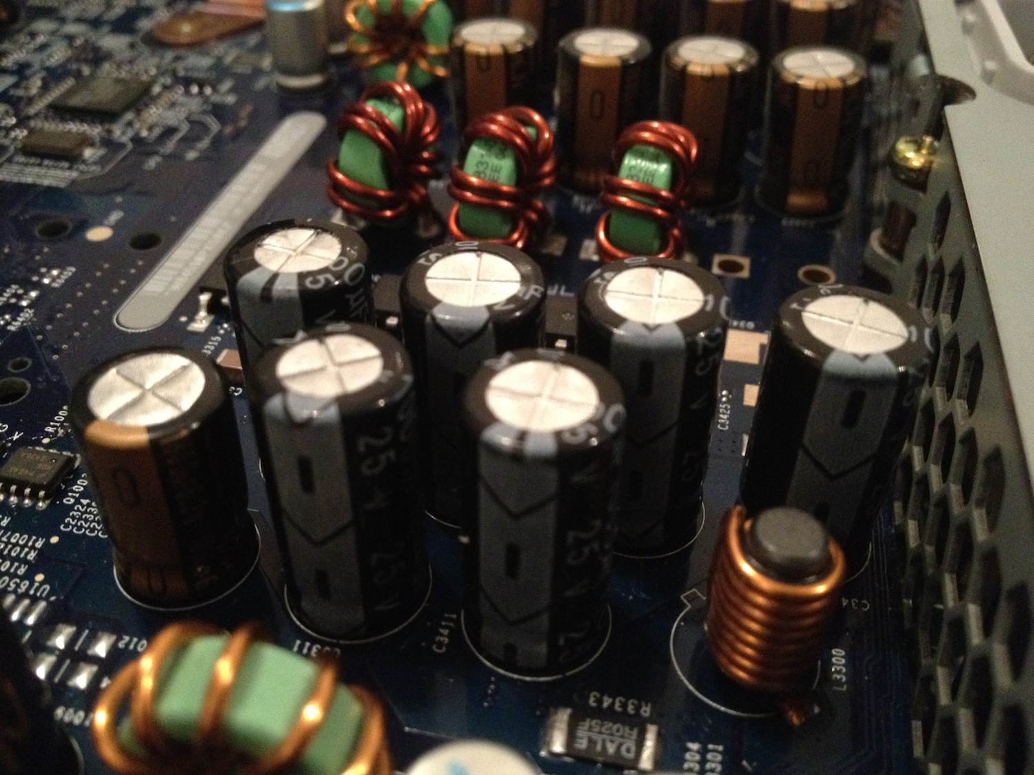

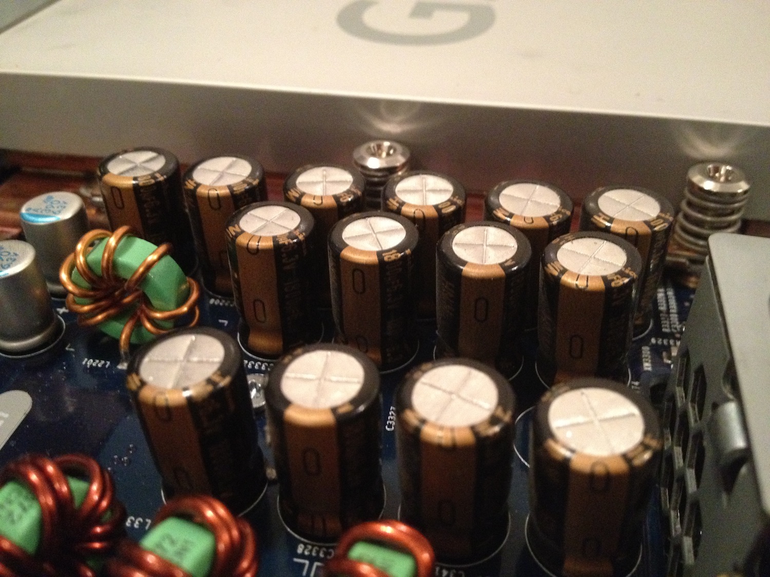

I did. But I made some pictures. I don't see anything out of the ordinary?
There are also 2 places where there are only 2 capacitors, they are fine.

It's possible those capacitors have just started to leak, and not bulged yet. Or just failed or leaked from the bottom. I've seen many different cases, all surrounding those caps. It is possible it is a bad graphics chip, cold solder joint etc. A new logic board would more than likely fix the issue. It's probably either caps or GPU.

The GPU is most likely the problem.
The tiny solder joints holding it to the board sometimes break, causing lines on the screen.
If you cover your logic board in tin foil, only exposing the GPU, then bake it in an oven (recommended temps and times are on the 'net), it will re-flow the solder and should fix the problem.
That is, as long as all of your capacitors are good.
