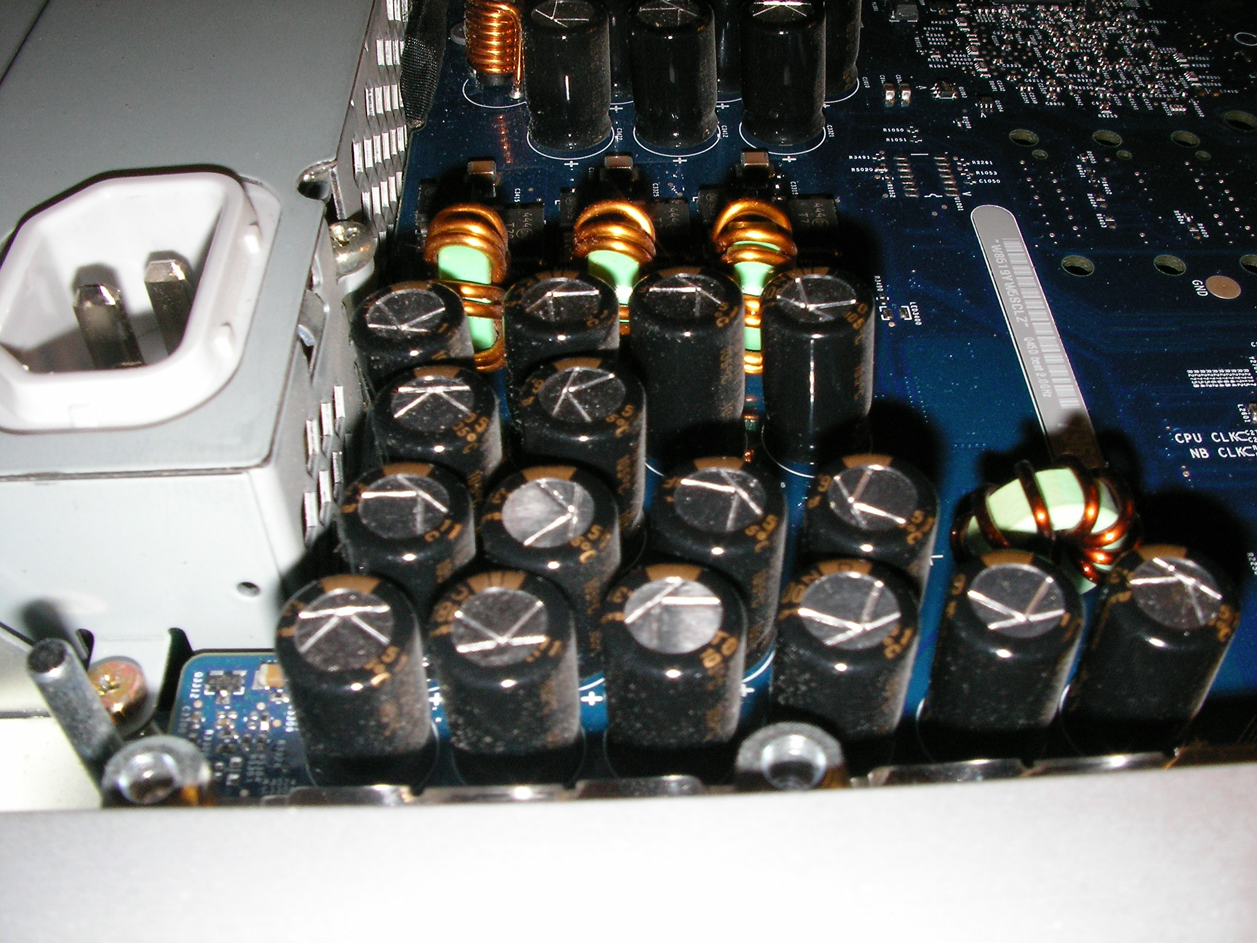

iMac G5 often had bad caps.
Search the web for iMac G5 cap replacement and you'll find instructions.
Hope you'll like to solder 😀

Replacement caps are $25 and apple will probably charge $800 for a new mobo, since they don't solder.
Check this link: http://jimwarholic.com/2008/07/how-to-repair-apple-imac-g5.php
Look at pics and see if your caps are bulging or leaking, it's easy to see
the caps all appear to be normal. Im not sure if photos will do any justice. but maybe youll see anything I dont.
