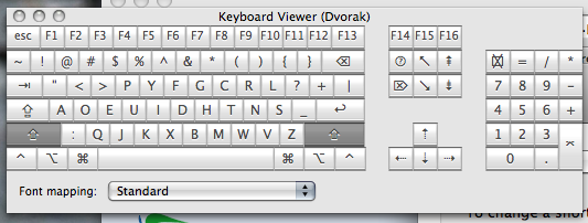

Wait, you mean the S key appears in lowercase here when you hold the shift key down?
Okay, and if you click the button in Keyboard Viewer you end up with a lowercase "s"?
(Sorry, I use an alternate keyboard layout.)
No, I get nothing, no letter, just a noise telling me "hey stop that!", that Mac beepy noise if I press that capital s on the picture, just like the warning beep I get when I try to type it. It just won't allow me to type it, unless I have the caps lock on LIKE SO. Funny thing is, the mac just now barked at me because I wanted to write a cap s with my finger holding the shift down. Only when the caps are actually locked can i write it. 😕
