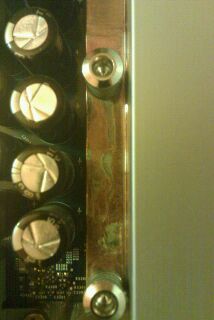

Hello, thanks for the replies. I opened up the computer and all of the caps were fine. And there was very little dust in the machine. So I'm not quite sure what would be causing the issue now. The pixels appear as soon as I log in now and get progressively worse (I'd assume worse as the temp of the computer rises). The only odd thing I found were these green spots on the edge of the G5 area. I attached a picture, not sure what that would have come from but it doesn't seem to me that it's a normal occurrence.
at least theses caps in the picture are fine , the green spots on the copper is oxidation , so i guess it was standing around in a humid environment for quiet a while or someone was washing it and water got inside ..which could explain something eventually water and electricity do not mix well on a logic board

Well where I live it's extremely humid in the spring/summer especially being that the computer is upstairs where it's warmer. So that would probably account for the oxidation. Thank you very much for all of your help! Everything is backed up on Time Machine so I'll see how things go and see how long of life I can get out of this until buying a new mac. I can just use the hunk of junk PC for a little if this one goes. But thank you once again!
