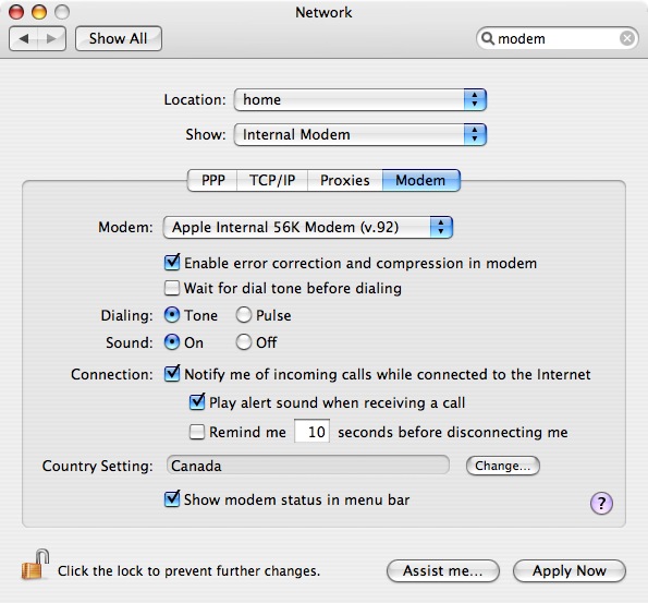

I'm thinking the dial-tone may be too quiet for that modem, at your friend's house. Have you tried un-ticking the 'wait for dial-tone before dialing' option, in the modem settings?
Hello thanks for the reply.
Tried "Do not wait for dial tone" amongst every other setting that could make a difference.
It's the fact that the old internal modem on the G4 is fine so you'd assume the problem is with the G5 and the USB Modem but like I said I've had them working everytime.
I cannot get over to the guys house as I'm working constantly - this is the main problem - it lies at his home.
Thanks a lot.
