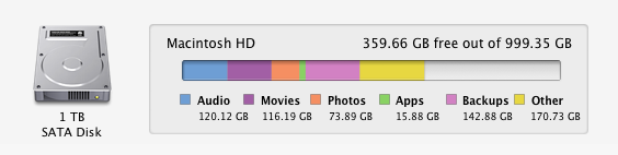

is that a 1TB drive by any chance?
if i recall, Time Machine uses your drive for local shadow copies when you are away from your Time Capsule and as a fallback in case the other backups were to fail.
here's what my drive looks like via About This Mac-->More Info..-->Storage
But if you look at the free space displayed, it's almost the sum of the backup space and the true free space.
