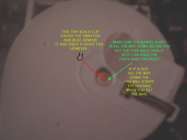

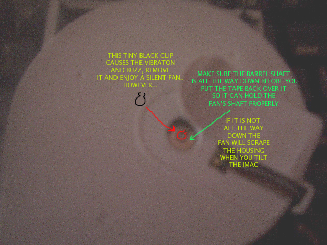

I bought my alum iMac 24" in July 08 I just went in to have the lcd replaced because some weird fungus/stain/dirt was growing on it - now I come back and my fan is on and running like crazy I've never heard this before and its driving me crazy - read every thread here and the SMC reset sounded like the best but it didnt work - freddyaudiophil's post said that when the techs replace the lcd they could screw with the temp gauge and I hope this is my problem as I'm taking it back in to the shop to see what they can do. Extremely annoying going in to fix one thing and having some thing else screw up.
I Think I Solved It!!
Addendum to my earlier post
--This may or may not apply to intel iMacs, but it is a 100% for white iMacs
Okay it wasn't the spring after all, the real culprit was a little black clip on the back of the fan that holds the fan shaft in place. I broke the clip on one fan to get to the spring and when the buzzing stopped, I assumed it was the spring, but another fan was still buzzing, this time I didn't break the holding clip and removed the spring but the fan still BUZZZED,,and buzzed even louder because the clip was bent out of shape when I reinstalled. That is when I discovered it was the stupid little clip!!!!
Long story short, now my fans rev all they like and all I hear is a breeze of air instead of constant buzzing even at low rev. For all the years white iMac owners have complained about buzzy fans and had expensive replacements that had the same problem the gremlin was a small black clip the whole time!!!, funny that, eh? 😀
I included a reference pic, If you have any questions don't hesitate to ask for help.
I would love to see if the intel model's fans have that little black clip, because as time goes on, it is going to start buzzing your ear off.
