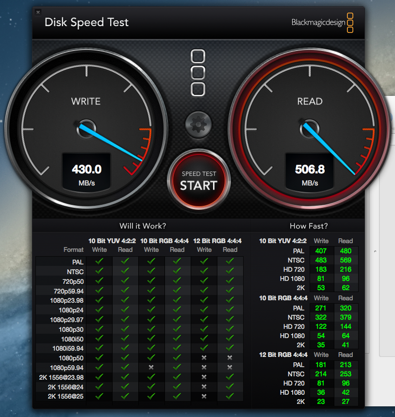

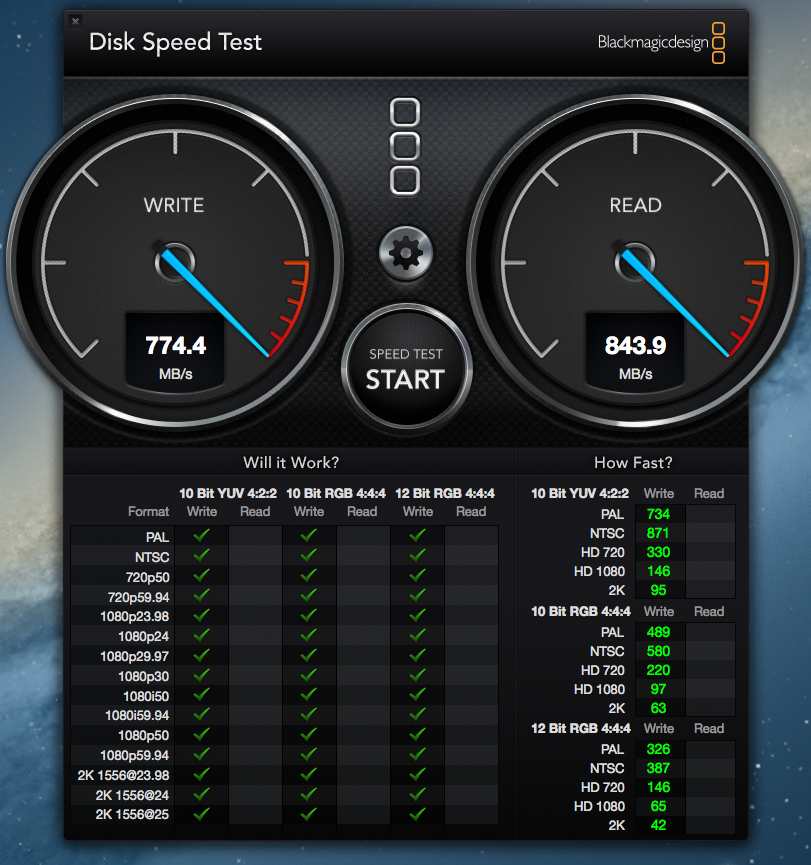

I bought the macmail lacie little big disk sata 2 ref for $ 160 I am very pleased with my purchase. After hdd replacement on the ssd Vertex 4 128gb in RAID0 speed is very good
I also replaced the internal hdd to ssd samsung 830 256gb and SSD Apple 256gb in RAID 0 speed is excellent. The difference in the speed of work of the iMac, I have not noticed.

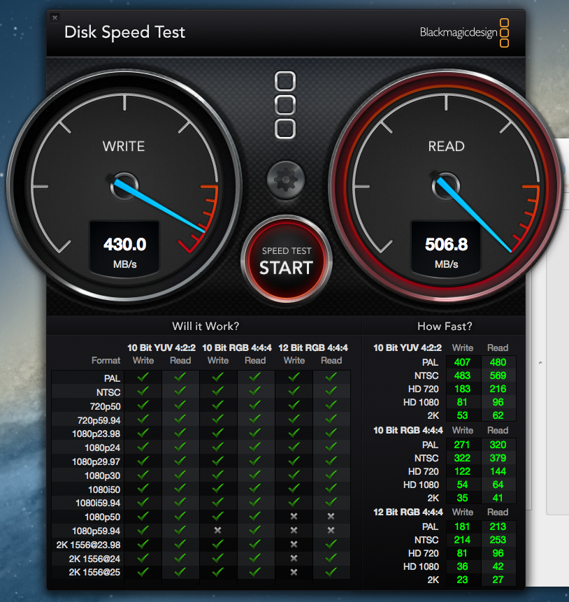

Only an internal SSD will give maximum performance.
A single external Thunderbolt SSD won't even give full SATA3 speeds, due to overhead.
External Samsung 840 Evo 500GB - 430MB/s read/write (mounted in a Buffalo HD-PATU3 TB enclosure)
Internal SM0512F 512GB PCIe SSD - 750 MB/s read and 720MB/s write.
In normal usage you won't notice any difference. In I/O intensive tasks like heavy video editing.
