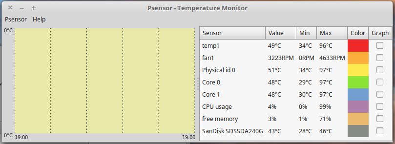

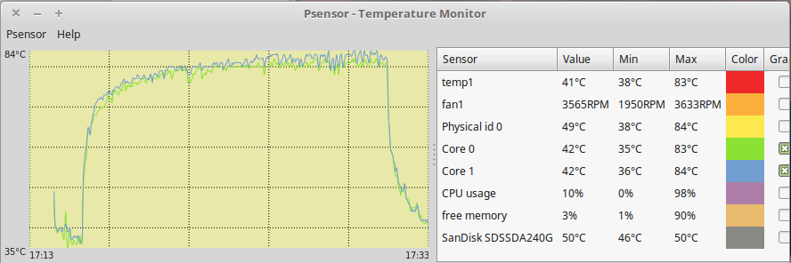

For example I just upgraded the CPU in a laptop I have and I ran my own benchmark (timed a video encode in handbrake) to see the difference in performance. However while I was at it I recorded temps since I had to reapply the thermal paste. Both CPU's have the same 35w TDP.
Before
After
Only relevant information there is the fan rpm max and CPU 0 and 1 temp max. So fan RPM and temps dropped significantly.
However while watching a youtube video the temps are about the same, except the fan is spinning slower. Its depends on the Macs fan profile what the temp is going to do.
