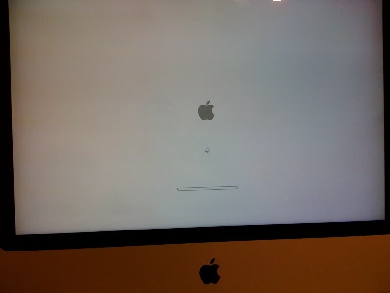

When I switch it on, I get this screen:
It stays like this for about 2 minutes and then the imac just shuts down.

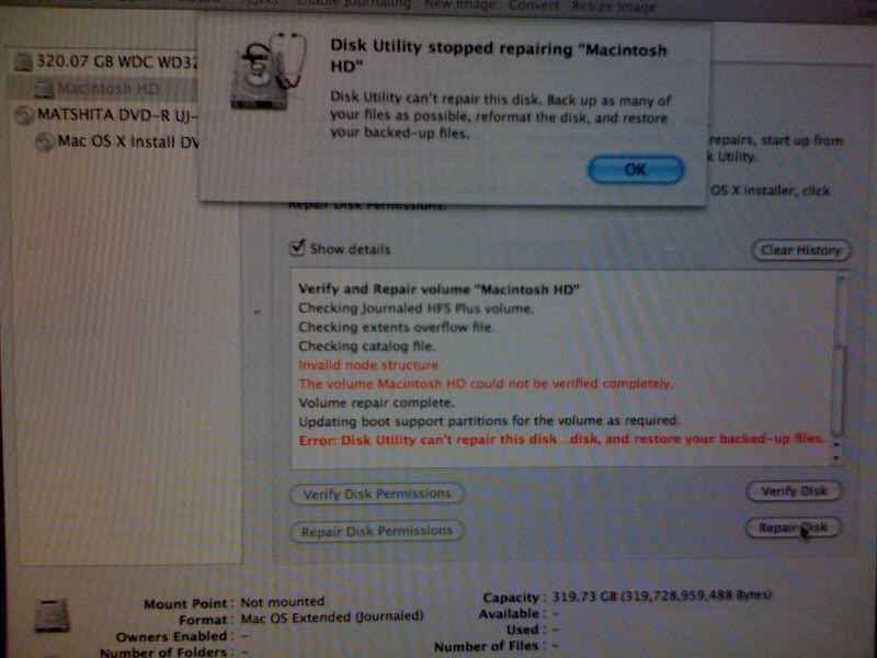

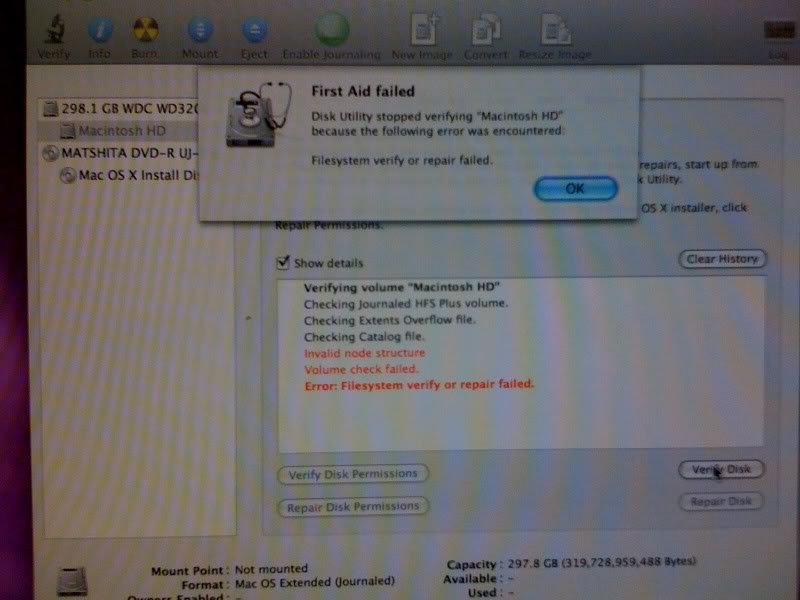

I tried booting from installation disks to verify, repair disk etc, but that's not working either:

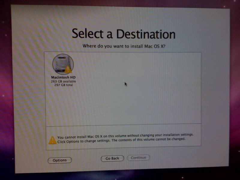

Trying to do a fresh install from scratch, but it's not letting me do that either:

Based on the reports from Disk Utility it does look like your hard drive is failing. Did you not back up your files?

I purchased Disk Warrior and tried it just now. No luck. This is the message I'm getting:
DiskWarrior has successfully built a new directory for the disk named "MacintoshHD". The new directory cannot replace the original directory because of a disk malfunction"
