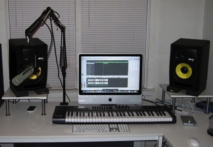

    Here is a picture of my current setup:
    [​IMG]

    Where did you get that desk? I need one for my studio monitors

    Hey TurboGrafx16Fan,
    The desk is the PERFECT set up for my studio. I actually have 3 of those desks in this room. The 1 you see holding the speakers and computer and then 2 lengthwise on the right that hold my TV, Printer, and a bunch of trash lol. I got them from.... IKEA! And guess what? They were only $49 each! They are super sturdy, very clean, and perfect for the job. Here is a direct link to them on the Ikea website:
    http://www.ikea.com/us/en/catalog/products/S59849977/#/S99849975
    The the stands that I have the speakers sitting on were just little mini table tops and 4 legs that I picked out for each stand. I cannot find a link to them but they are also from Ikea. The bottom of the legs have rubber on them and help absorb any vibrations that come from the speakers. I also have the speakers laying on Auralex Mopad Monitor Isolation Pads. A must have in my opinion. Here is a link to them:
    http://www.auralex.com/sound_isolation_mopad/sound_isolation_mopad.asp
    [​IMG] [​IMG]
    [​IMG]
