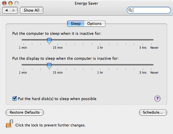

Have you set the hard disk to sleep when possible? Actual RAM will limit Virtual RAM usage but not stop it entirely. Even if you get rid of the Virtual RAM, the hard disk still needs to be accessed for many different reasons. After all, it's where (almost) everything is stored. 🙂

Yep, HD is set to sleep when possible. I do have limewire, but not "on" all the time. I have 768 mb of ram!?..Isn't that enough to keep the hd from spinning constantly?

If you don't check "sleep when possible" for the hard drives, then the HD's spin whenever the computer is in use. I used to have that checked, but it got annoying to wait for the hard drive seemingly all of the time. When you put the computer to sleep the hard drive does spin down. The only thing active is the motherboard to keep your RAM contents around.
