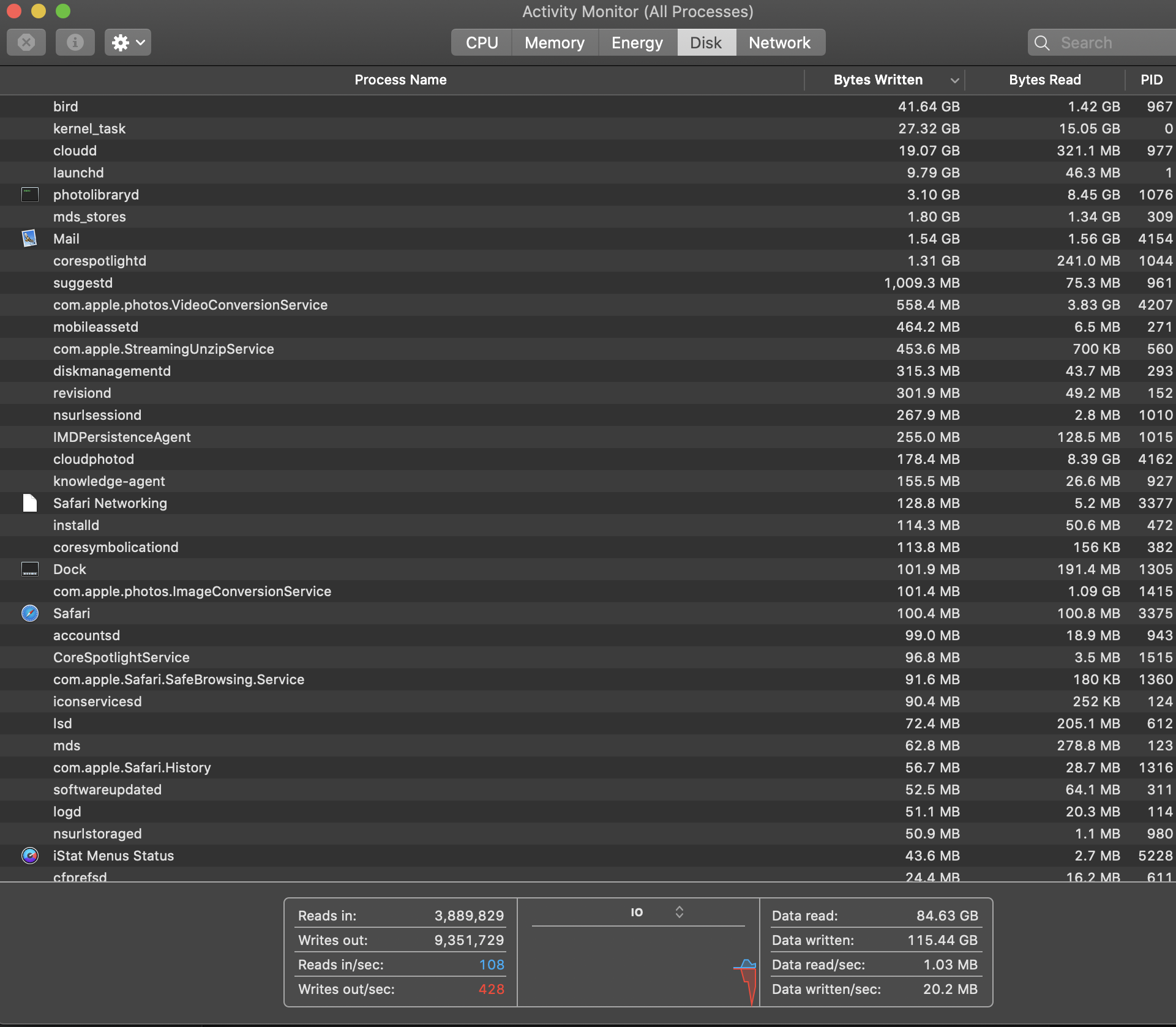

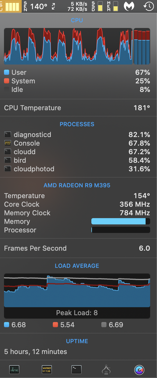

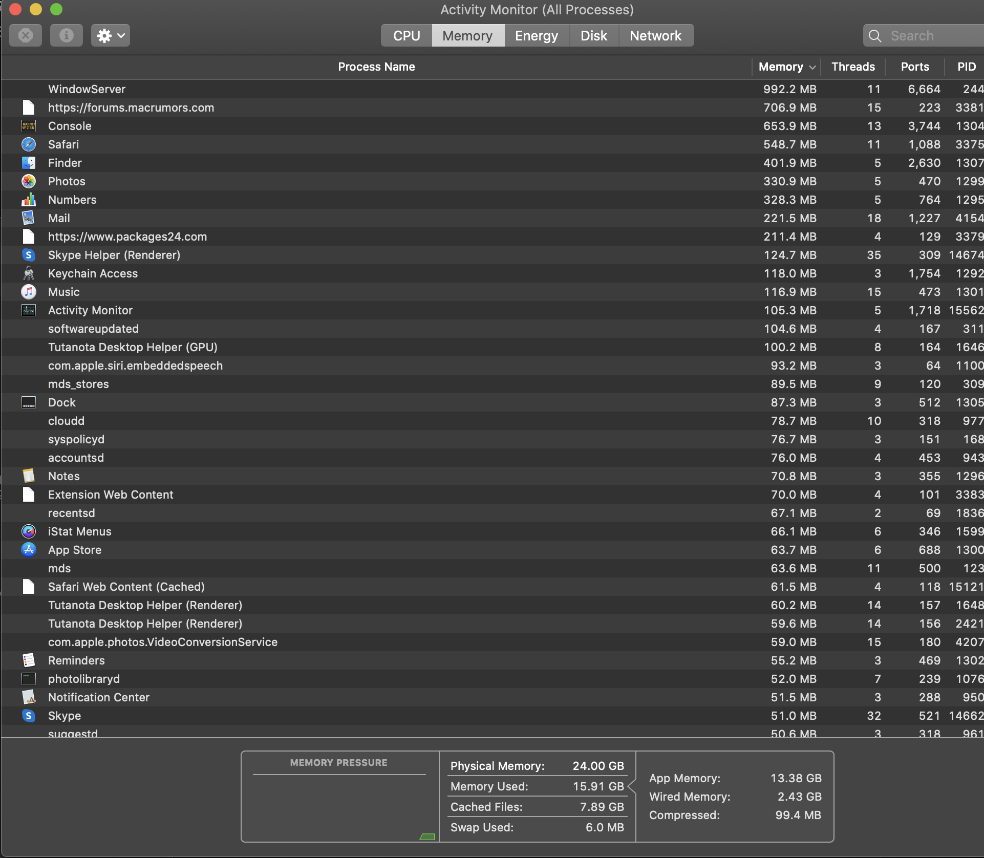

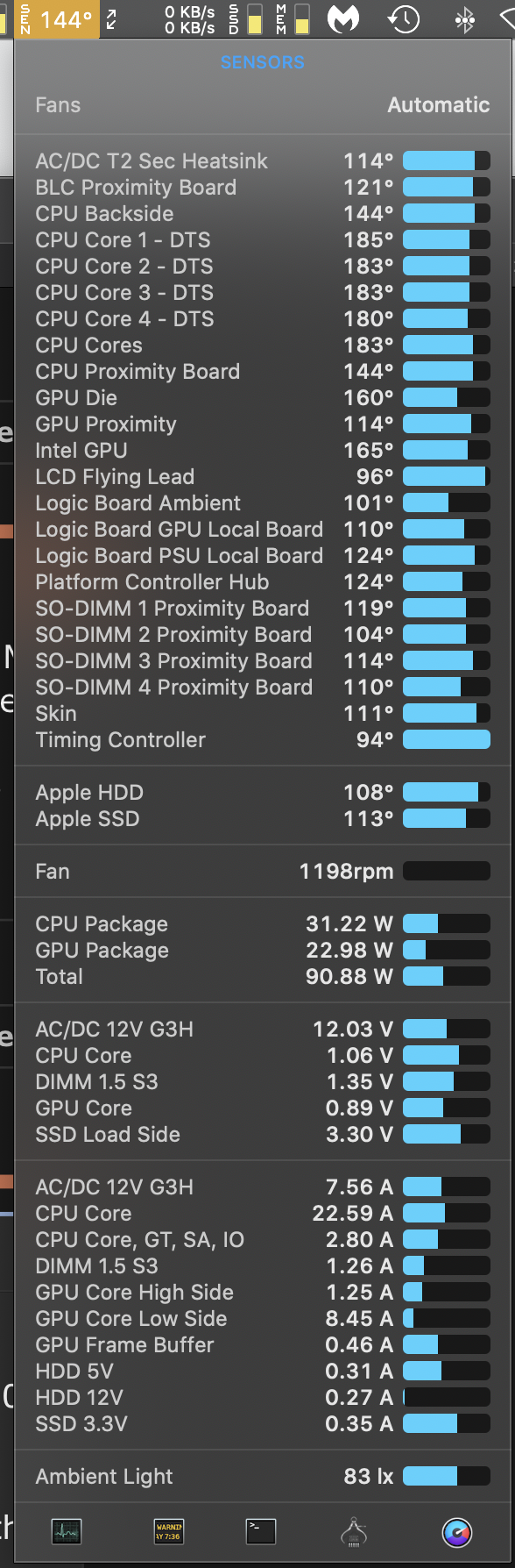

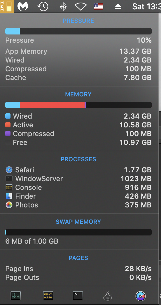

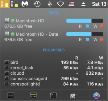

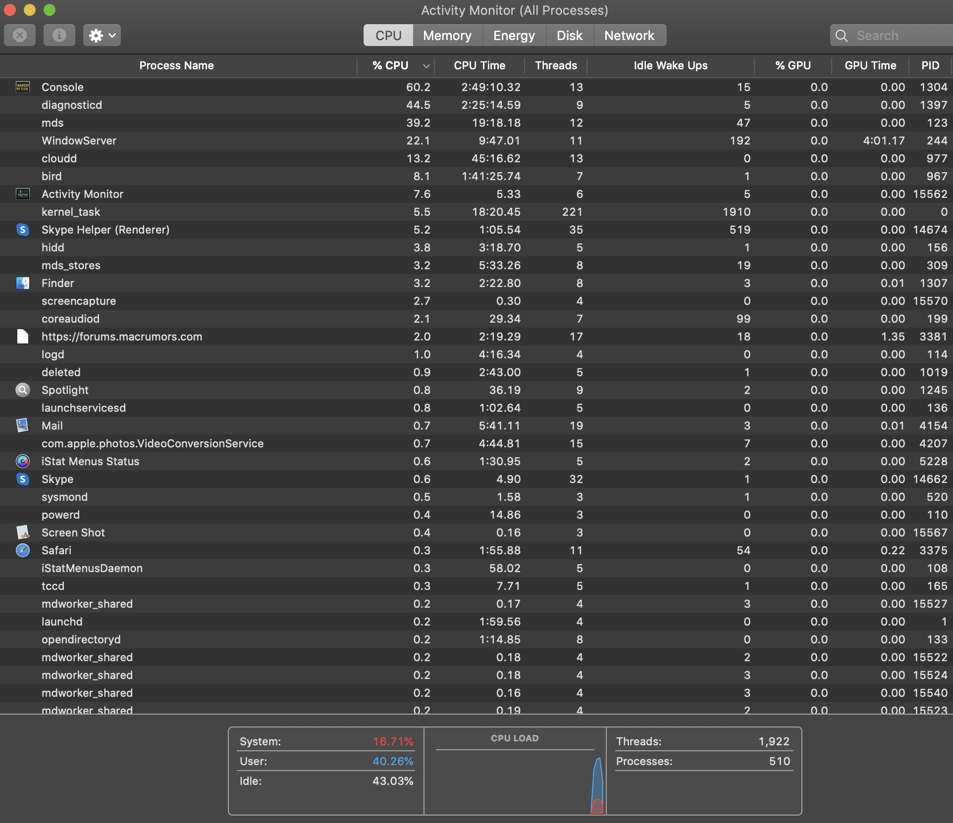

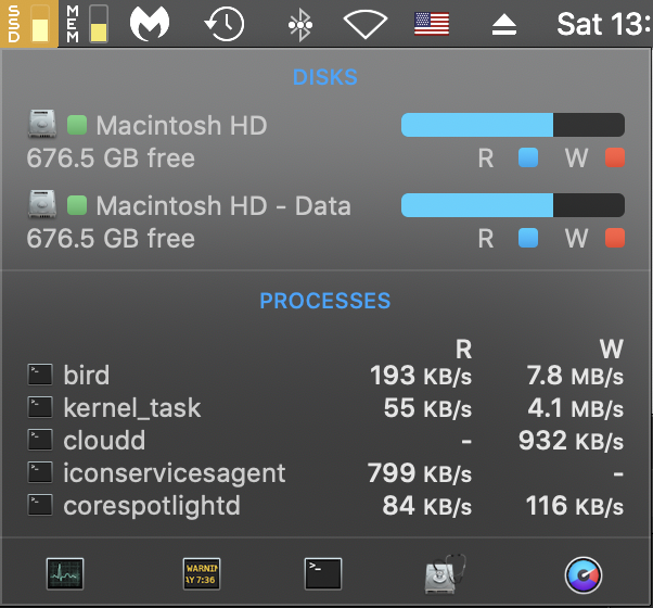

So, I performed a clean install and restored all of the files and apps from my Time Machine backup, and will wait to see if I experience again the freezing issues, but it seems I am getting the same high temps like before. I am posting some screenshots of the temp readings and how many processes are running on the computer right now, maybe that way somebody can tell me if those high temps are normal?
Your temperatures are really perfectly fine. Official numbers for these sorts of things are always in Celcius, but the Intel chip is rated for up to and including 100°C, at which point it'll reduce its speed. Even without the fan being above idle, you're keeping yours below 85, far below Intel's rated limit. And that's not a hard limit at 100°, that's just a limit for normal high performance. There's headroom above that before you reach automatic shutdown.
The GPU is rated for up to 105°C before throttling, and 110°C for automatic shutdown; At least the R9 295X was.
Your temperatures really don't seem to be the issue.
Reactions: AlexGraphicD
