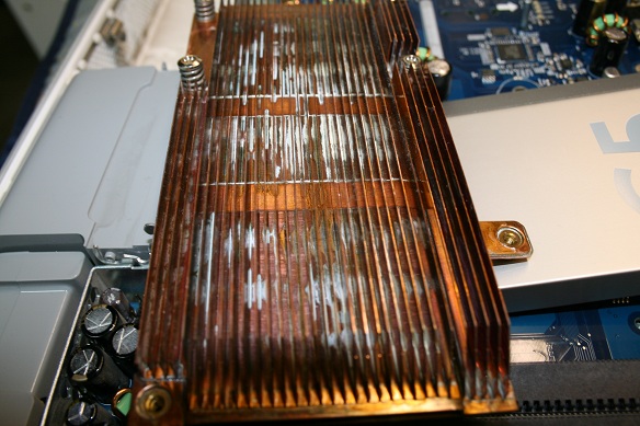

This is the cpu heat sink. The fins are corroding where they attach to the main plate.
Educated guess:
I'm thinkin' maybe the corrosion impedes the ability to properly cool down the cpu, causing the system to have errors, and turn the fans on.
Question for my forums peeps:
Do you think that this corrosion is part of my problems?

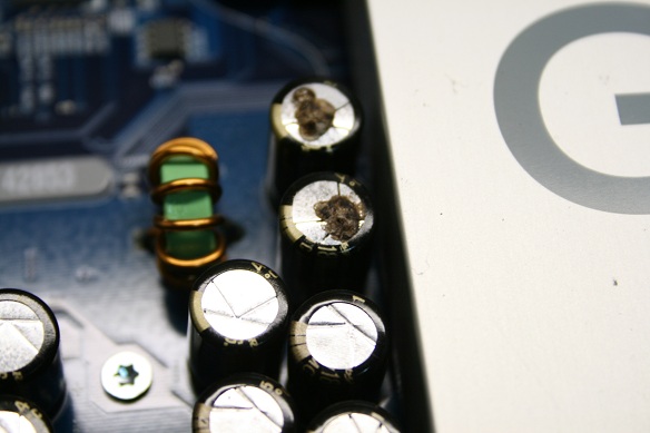

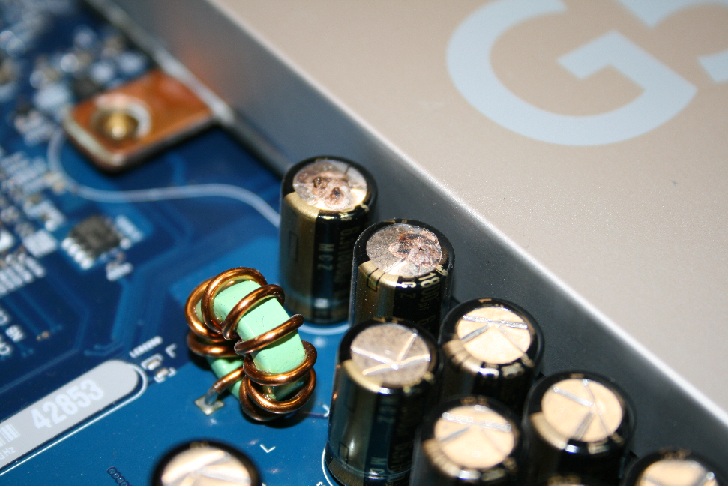

These parts are next to the CPU. They're leaking through the top. After I scraped off the leakage, I noticed the tops of the components are not level like the others. It looks like when you stick a soda in the freezer and the top explodes. Like there was a lot of pressure inside and it tried to escape. Ok, it doesn't look as bad as an exploded soda can, but it doesn't look like it's sister components. The tops look like the letter 'K' and the leakage is from the center of the 'K'.
Question for forum:
Do you think this is part of my kernel panic / freezing problems?
It is a known issue that some iMac G5 has bad capacitors. They start to leak and that makes your computer crash. They need to be replaced. I think Apple fixed it for free for a while but I am not sure since it is such an old computer now. If you google iMac G5 capacitor you will find lots of tips and help.
if you've got decent soldering skills it can be fixed easily but if you don't it could be costly to fix to pay someone. For the age it may be worth finally upgrading. You can sell it as is on eBay and get about $150ish.

Thank forum peeps! Those are some very helpful answer, I really appreciate it.
I'm going to try and replace those leaking parts.
I'll report back and let you know how it went.

🙂 I see! Strange to see that corrosion anyhow, havent seen that on any models besides the water-cooled Power Mac G5s before. Perhaps it is the "goo" from the capacitors that have leaked down on the heatsink.
