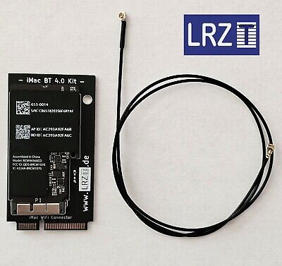

Yes, you can buy them directly from the German company LRZT. Just send an e-mail to info@lrzt.de
or on ebay:
Updated with the LRZT 4.2 kit, took a while to hook it up and get recognized, noticed a loose connection and that fixed it. Updating from Sonoma to Sequoia, hope it goes well. I also looked at the China version from HonTec. Much more complicated to hookup than the German version related to BTooth wiring. The German version was more expensive. I'm going to selll the Chinese one on eBay. If anyone wants it here, please let me know.

To contribute to the community regarding the Wi-Fi and Bluetooth issue with an upgraded Wi-Fi/BT module on a 2011 iMac: Ensure the Bluetooth connection is properly seated and powering the module. I struggled for a long time to get Bluetooth working and finally discovered that the module had soldering issues. I fixed it by slightly adjusting the connectors and securing them with a piece of electrical tape. The OCLP (OpenCore Legacy Patcher) recognized it immediately without any issues.
