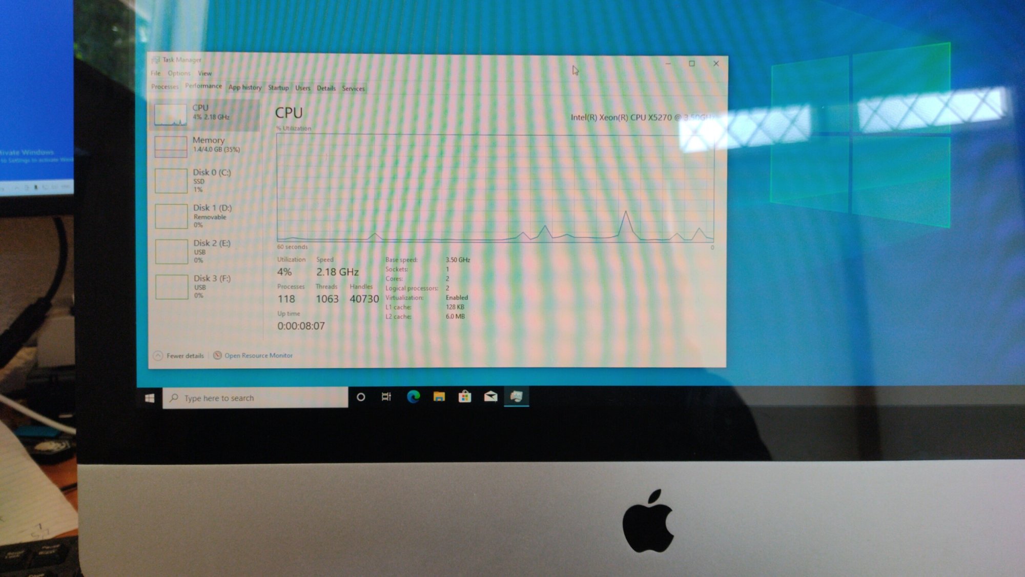

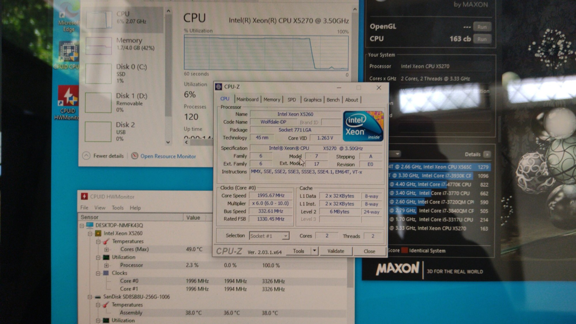

So that takes me to my current attempt to get the X5270 working, which is basically an E8700, fundamentally its the same as the E8600 just slightly faster. Unfortunately simply swapping the B1 (775) microcode for the 44 (771) microcode doesn't do the trick, without the 775 microcode the imac refuses to post. You must have the 775 microcode somewhere in the first microcode slot for the imac to post, but if you try to run windows or macos with the 775 microcode it just gets hung-up and restarts.
The semi-solution to this is to have the 775 microcode and the 771 microcode. If you do that it posts, then it seems to try and switch to the 771 microcode. Which sort of works...?? Once it seemingly loads the 771 microcode you can then boot into windows.... but still not macos. But it gets weirder, the CPU is multiplier limited to 10x (3.33ghz), and is detected as X5260?????
