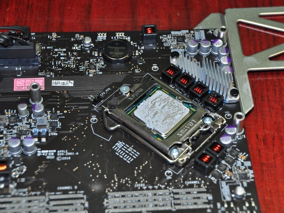

If not great with tools and following instructions, consider having it done and here's why: The NV RAM battery is on the back of the motherboard and after 11 years, it's way, way past time for its replacement.
Thanks for bringing up the NV RAM battery thing, never crossed my mind & first mention I've seen of it. But, REALLY???
You have GOT to be S..T..G me! REALLY??? 😱 I've found this and other "how to's" & video (kinda funny actually) on replacing the battery: https://www.ifixit.com/Guide/iMac+Intel+21.5Inch+EMC+2308+PRAM+Battery+Replacement/1970
Up until this point I was becoming pretty well impressed with Apple/macs engineering! But this, this? 😱 What did the Apple engineers do, sit around a table drinking what ever and decided they'd make this thing as f..k..g impossible to repair as humanly possible? This thing is made like an appliance or something one might bought 40+ years ago before the move to make things more easily manufacturer able & repairable!
Just to replace a battery! Oh well, at least now I know what might be in store for me if & when I decide to do this! Good thing I'm retired I guess!

Well, in 2011, they put it back on the front where it can be replaced easily. But yea… I agree.
Thing is a bad battery doesn't just lose the settings like on the Beige G3 and earlier. Since the B&W G3, it messes up the GPU. I've no idea how much money has peen spent on GPU issues because the BR2032 was too low. Heck, if it was missing or stone cold, the GPU would be unaffected and the symptom would be that the iMac can't remember its settings.
